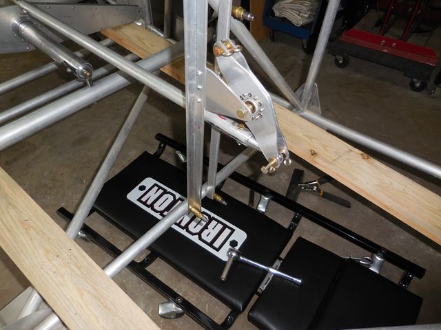

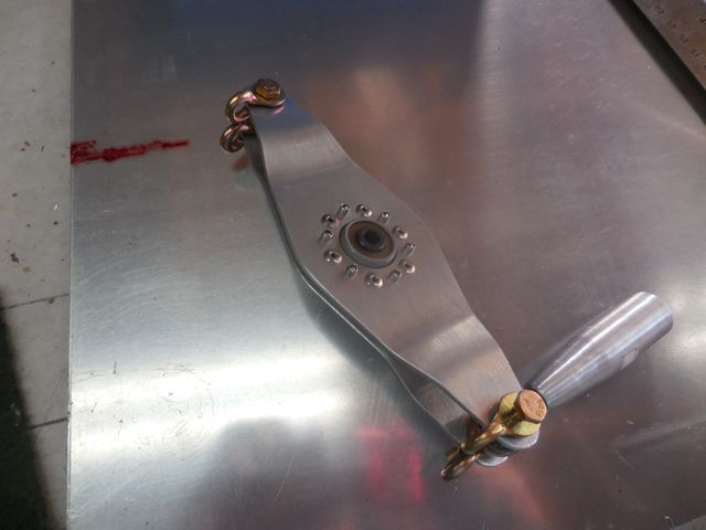

    Had a good day of work yesterday. In the morning Rose and I constructed the aileron bellcrank.
Size:  41.5 KB Name:  m_DSCN2326.jpg
Size:  48.0 KB Name:  m_DSCN2332.jpg

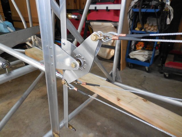

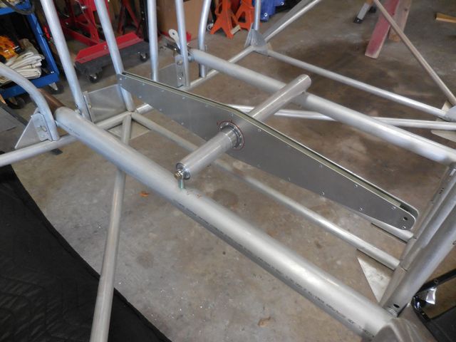

    In the afternoon we built the elevator bellcrank.
Size:  23.2 KB Name:  m_DSCN2336.jpg

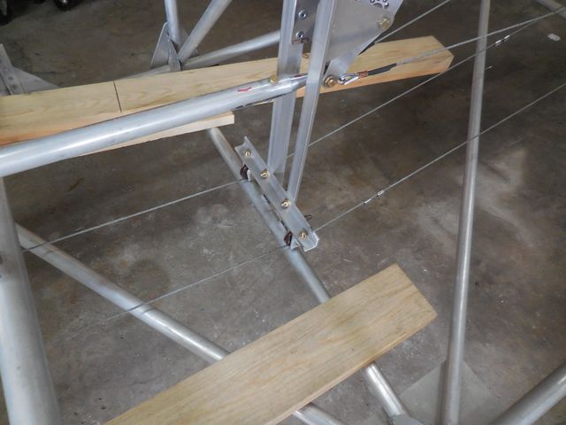

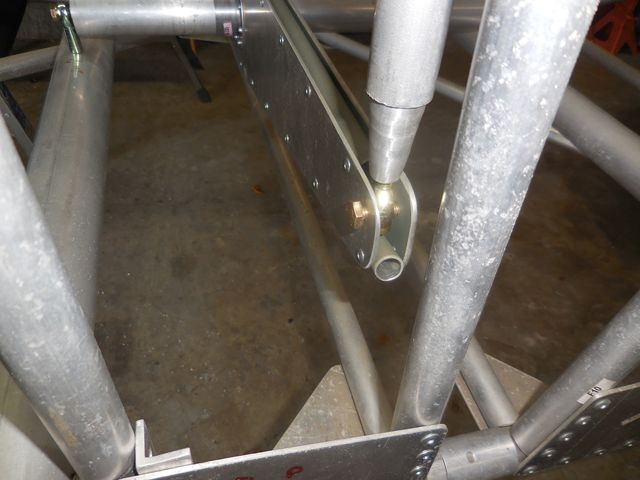

    The spacing of the angles to mount the elevator bellcrank must be widened. When the control stick moves side to side to operate the ailerons, the front of the elevator push pull tube does also. At the width in the photo, the tube will hit the angles. Just need longer spacers.
    Dale
    Dale Cavin
    Florida Panhandle
    Current Project: Airdrome Aeroplanes Full Size Nieuport 17
  3. #213
    Alabama
    2,236
    Oh, I see what you did there in keeping the elevator rod low.
    Rather than a bellcrank, consider a round bushing where the lower tube goes through there instead, and a join of the two push-pull tubes.
    That way they can twist and the lateral motion won't become vertical.
    If you're not a big fan of the long portion of the elevator tube shaking around and flexing, I'd suggest putting in another round bushing for it further down as well.

    I'm not sure I follow you Frank. There is only one short pushrod to the elevator bellcrank from the control stick. Cables from the bellcrank back to the elevators.

    Oh, I thought it was a push-pull rod all the way back, like mine.
    I only have cables for the rudder.

    Elevator cables are complete.

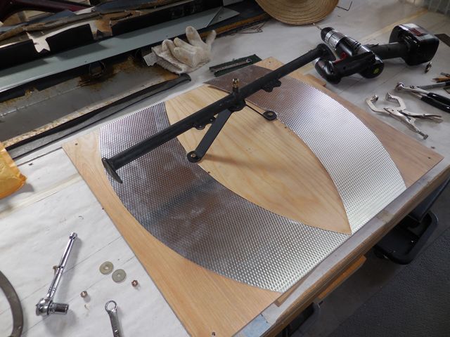

    Rudder bar assembly is installed. The floor board will have heel plates attached and a cutout for the rudder cables to go under the crossmember.
