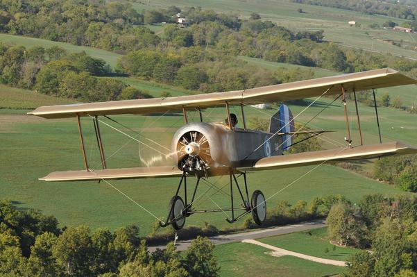

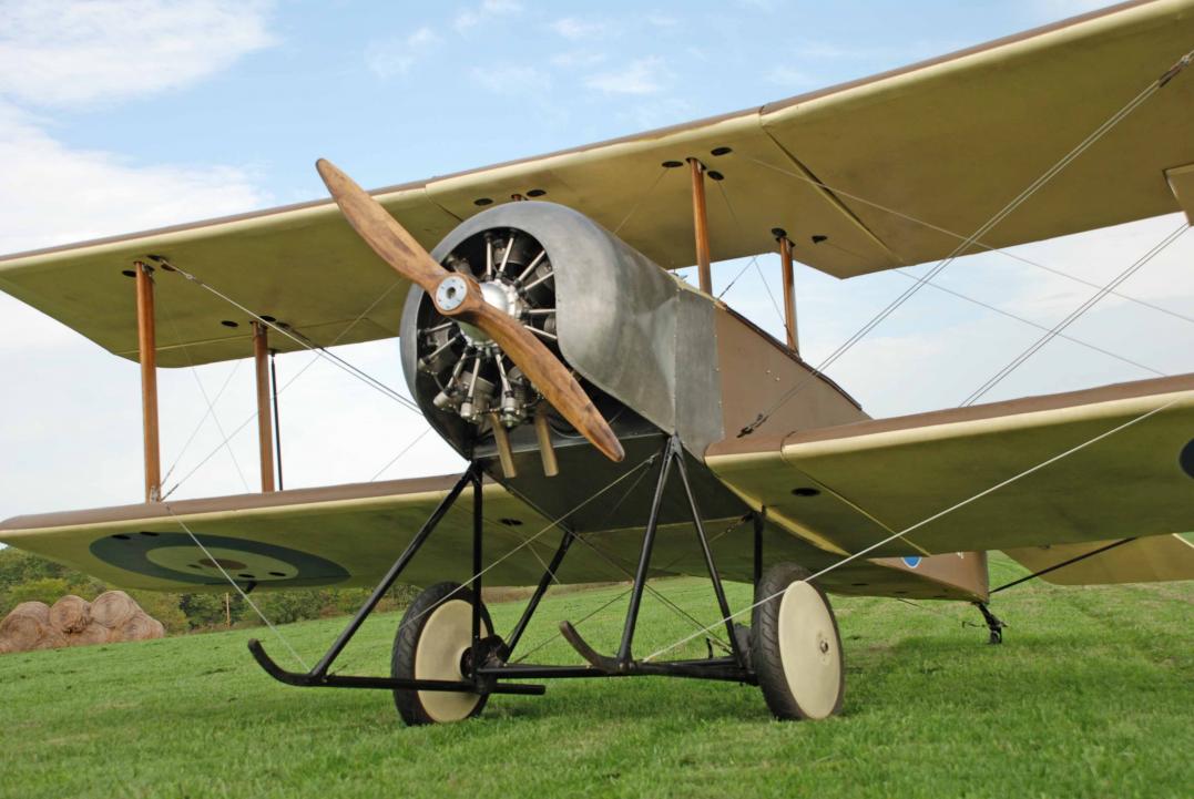

    Flown in formation with a 100 hp Piper Cub, here is the Airdrome Sopwith over Missouri. Photos courtesy Bob Punch.
