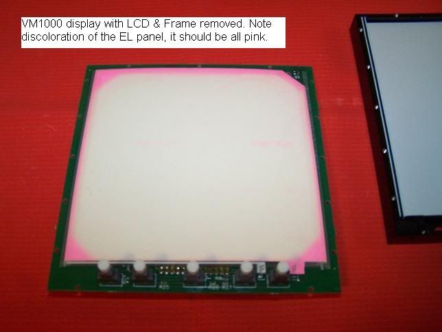

Because the ELP has a phosphor coating, it is susceptible to moisture damage from direct contact or high humidity. Hence, most ELPs today are hermetically sealed in plastic laminate. As I have found in repairing these units, this was not the case in the days when VMS manufactured their systems--almost 30 years ago (EPI-800s) or 20 years for VM1000s. Easily 80% of the ELP failures I've found appear to be due to humidity/moisture invasion of the phosphor coating via unsealed edges of the ELP, either not properly edge sealed or were cut and sealed with regular cellophane office tape which degraded over time. Once moisture contaminates the phosphor coating, it no longer glows. Based on the sample set I've seen, improperly sealed ELPs seem to last on average about 12 years or less. See picture 1 below.

PHOTO #1
