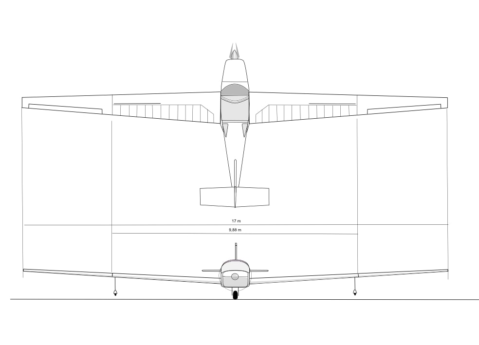

    Cross section of fuselage is enlarged by spar and position of pilot, passenger, side by side
    semi-reclined seated.
    What is your opinion about this configuration as cross section of fuselage is a question of
    performance ?
    Note: fuselage is 1.7" taller than Europa XS-Liberty XL fuselage (which XS version is a
    motorglider). Other classical motorglider configuration is with cabin forward spar (as phoenix
    motorglider).

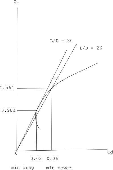

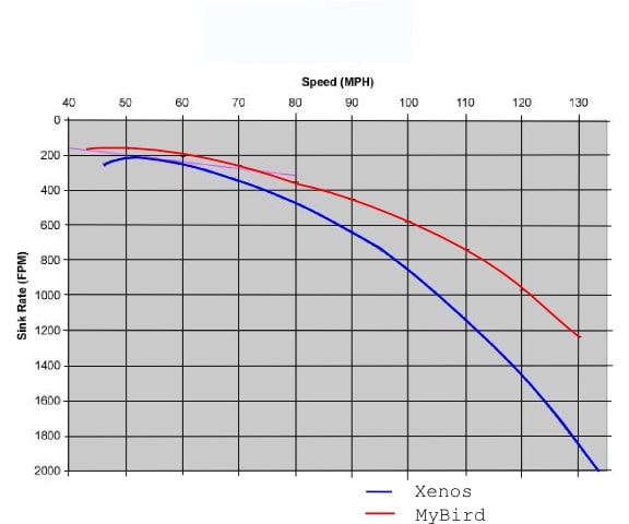

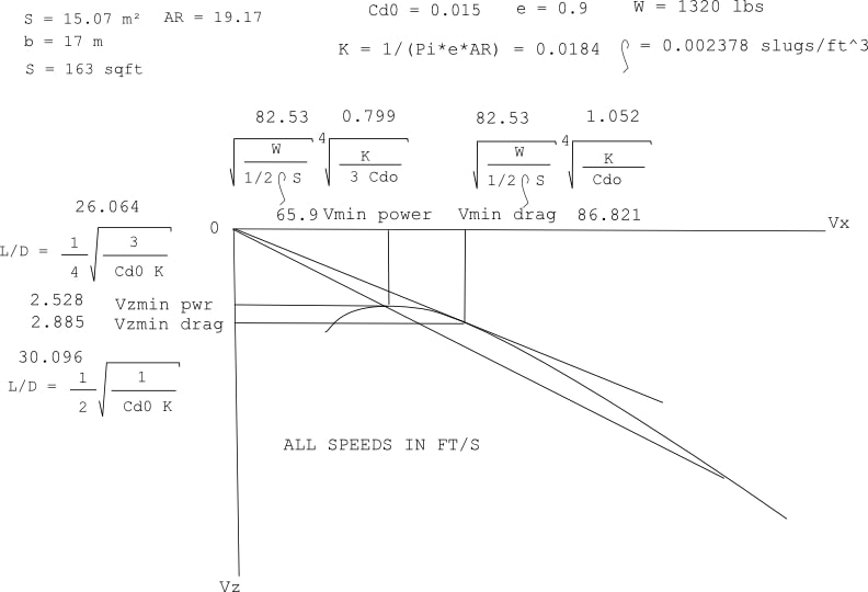

    Albeit a counterintuitive task, playing with polars (airspeed/rate of descent and lift/drag coefficient)
    gives you a glimpse of a glider performance.

    N.B formulas come from here http://www.dept.aoe.vt.edu/~lutze/AOE3104/levelflightperf.pdf
