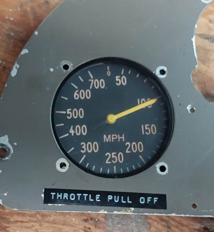

    Thanks much for the advice. If I were building a 4" instrument, I'd probably use a router. But I bought the Amazon 3" disks, because if I build any more instruments, most are probably going to be three inches.
    A quick slap-together of the final product. It's not actually bolted to this old Warwick Bantam instrument panel, so it's not lined up.
    Instrument face is just printed on plain paper with a standard ink-jet. I have a small sublimation printer that'll put some gloss on it; may give it a shot.
    Learned quite a bit on this one, will come in useful if I end up making any more.
    Justin, Texas
    232
    Didn't know the Bantam was that fast....

    Of course! "Bantam" is an anagram for "Batman", you know.... :-)
    Actually, my model was a P-51 airspeed.
