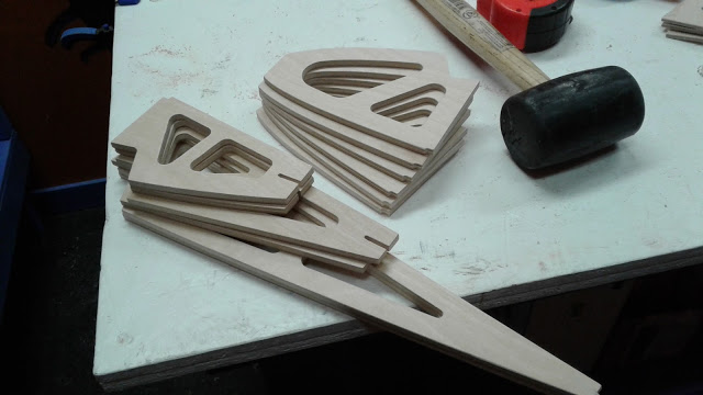

    I've been using a CNC router for a few years for my Hatz build. I have cut plexiglass, wood and now aluminum. Depending on the max size you want to cut, a small 12"x24" CNC router will cost less than $500. It's my most versatile tool. Some projects:
    Wood nose pieces for the wings.

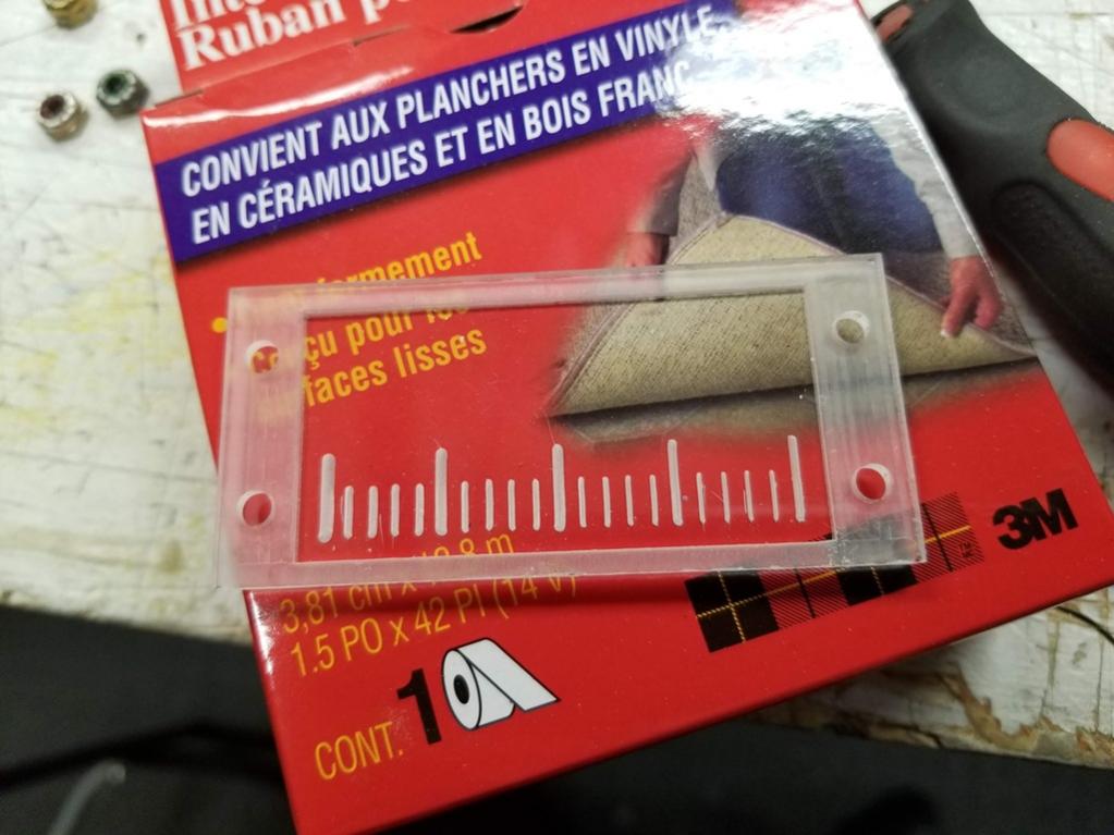

    Face plate for elevator trim cut from plexiglass.
