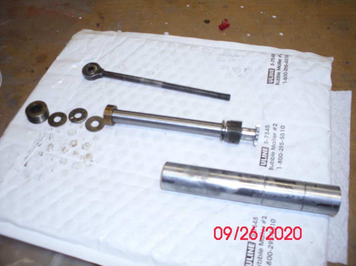

Thread: Cessna trim actuator
    May 2012
    123

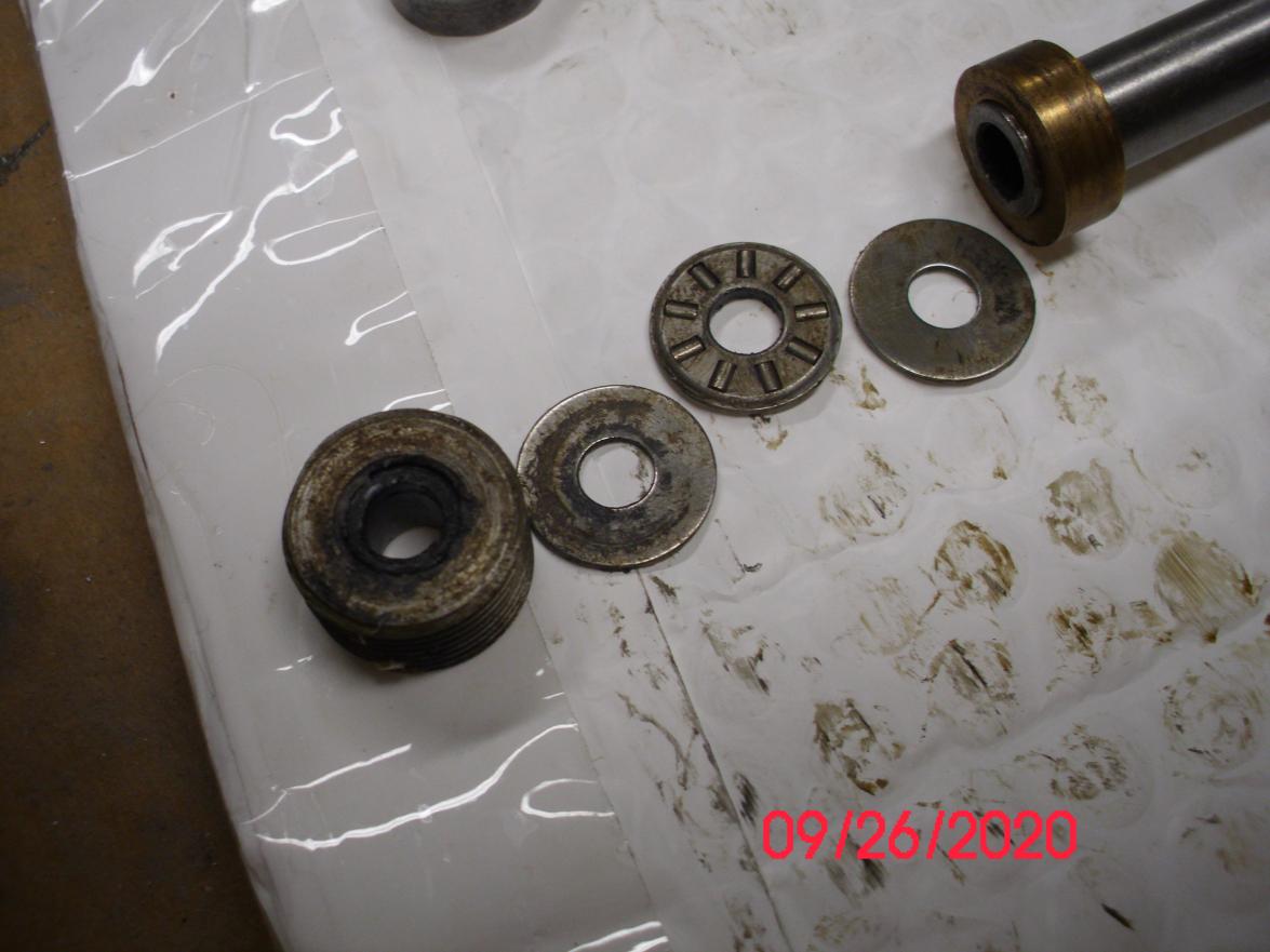

    I am trying to identify the part number of a Cessna trim actuator. Externally it looks identical to the Cessna 100 series elevator trim actuators, however it's has a steel case and the end bearings are threaded into the case and secured with only one groove pin on each end. Internally it is much the same as the standard trim actuator, except it has a very thin roller bearing plate on each end. It is not a MacFarland replacement actuator. Any clues ????

    Cessna part number is 1260074-1 and is used on 100 series and some 300 and 400 series aircraft. Are you sure this is Cessna part? Got a picture?

    Thought possibly it may not be Cessna, but in my 50 yrs of working on GA aircraft, I only recognize it as Cessna. Photos attached.
