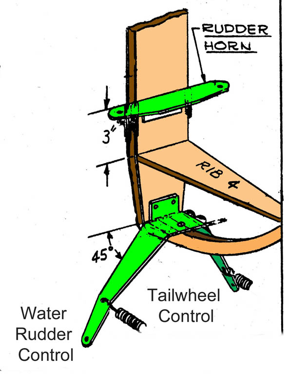

    I had exactly this problem when I first started flying N500F, the original Fly Baby. When the tail came off the ground, the nose started heading left.
    N500F had, way back in the past, been put on floats, with the tailwheel control system being connected to the water rudder. It didn't give enough command authority, so Pete Bowers welded on extension tabs to the tailwheel control horn:
    The springs in this illustration show where the tailwheel control springs normally attached. When on the floats, the holes at the end of the extensions were used, instead.
    At some point during its 1982 restoration, the tailwheel springs were connected to the holes on the extensions. When I started flying N500F a few years later, I noticed it would dart off to the right as the tail came up. I switched the tailwheel springs to the "normal" position, and the problem went away.

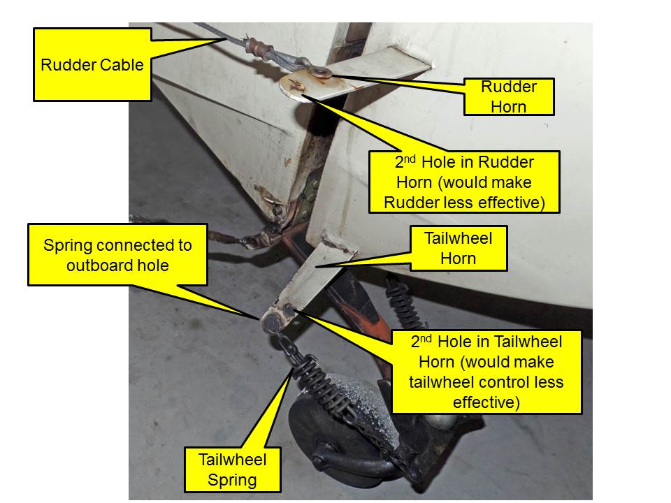

    2,881
    OK, found a picture of my own Fly Baby's tail. This should illustrate what I mentioned in the last post.
    Note that the tailwheel is pointed backwards because I'd just rolled the plane backwards into the hangar (through a pile of kitty litter, ew).
    See if your airplane has similar adjustment holes.

Size:  84.2 KB Yes it has the adjustment holes, but they are already as far out as is possible. Would stiffer springs do the same job?
    2,881
    Quote Originally Posted by bigbluvic View Post
    No, the problem isn't the effectiveness of either the rudder or tailwheel controls, but their mismatch in effectiveness at rotation speeds.
    Again, this boils down to exactly how the problem manifests itself. If you're holding right rudder to keep running straight during the takeoff roll, and have to push MORE right rudder as the tail leaves the ground, the rudder is less effective than the tailwheel. You can decrease the tailwheel control effectiveness by moving the upper end of the spring to the open hole in the rudder horn (on both sides, naturally).

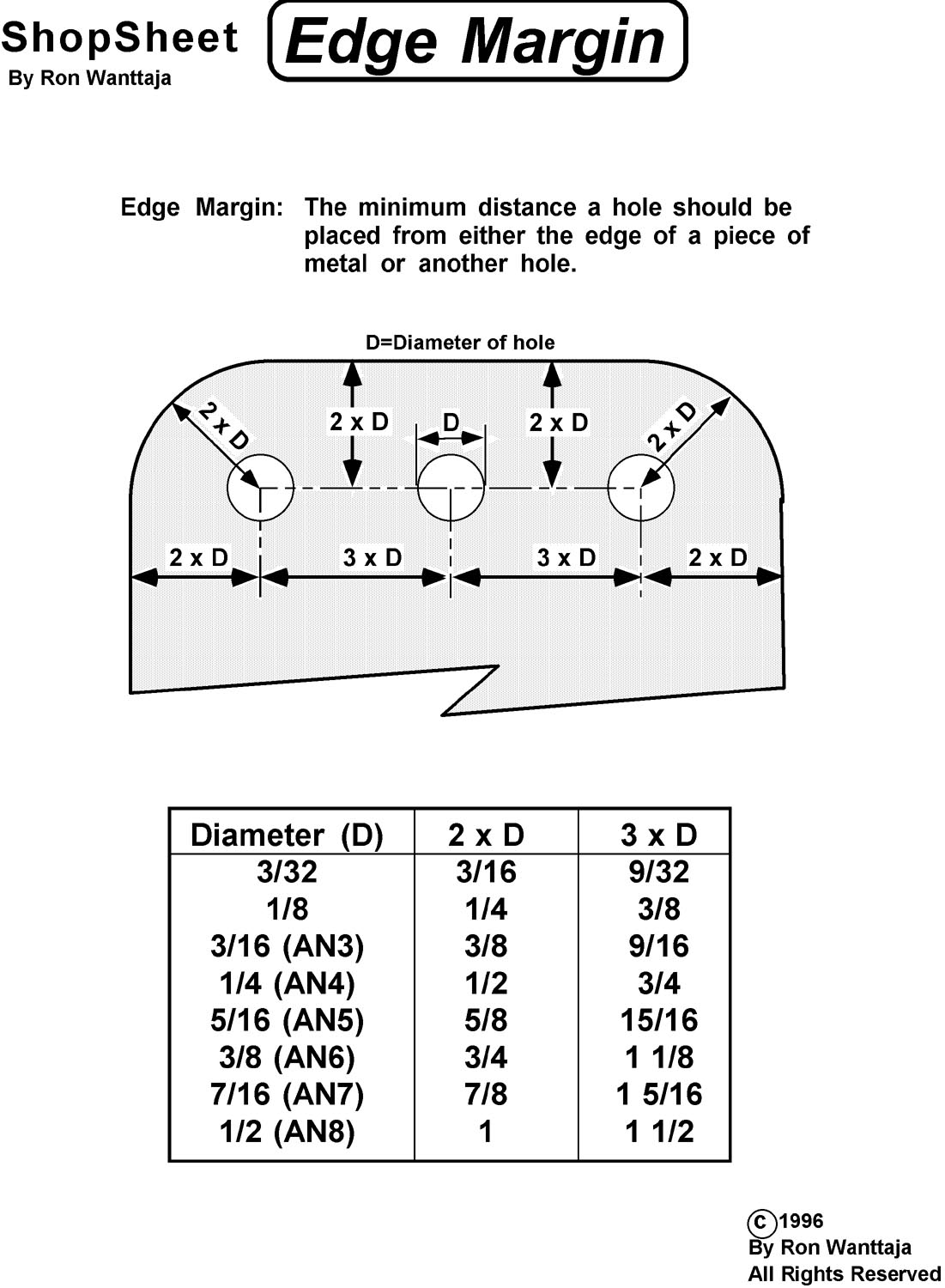

    If the problem is the opposite (you suddenly need less rudder pedal when the tail comes up) you'll need to attach the spring further in on the TAILWHEEL horn (again, on both sides). There isn't a hole for it, so you'd need to drill your own. The center of the new hole should be AT LEAST three times the diameter of the hole from the center of the existing hole, and, of course, centered between the two sides of the horn. So if it's a 1/4" hole, its center should be 3/4" from the center of the existing one.
