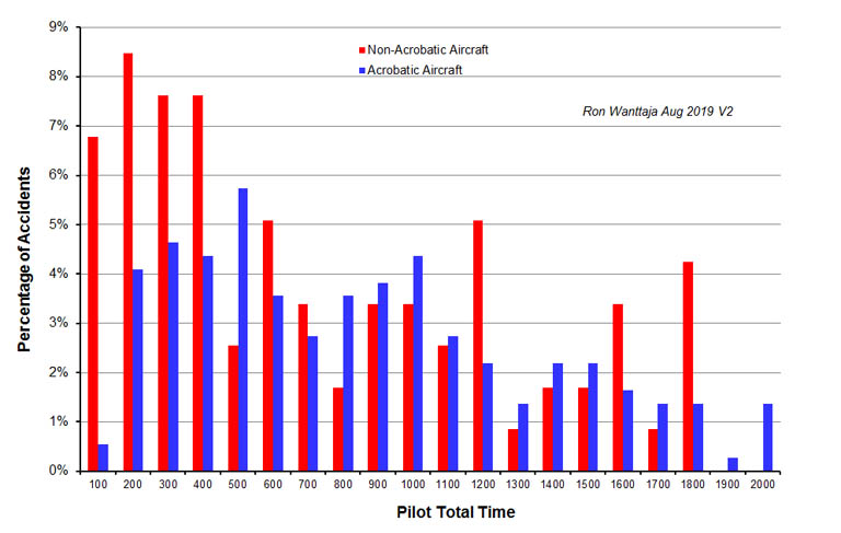

    The most interesting result came when I plotted the pilot total time as a histogram:
    This figure plots the percentage of the total accidents for each type vs. the pilot's total flight time. Note how relatively few accidents occur to lower-time pilots flying aerobatic airplanes. A lot of this is probably driven by the fact that few 80-hour private pilots buy Pitts Specials! But it does indicate that a lot of accidents in non-acrobatic airplanes involve relatively low-time pilots.
    But of course, experience is no assurance that problems may not arise. Nor is experience, nor is even the size of the airplane involved....
    (you might have to hit "reload" to get the updated version)
