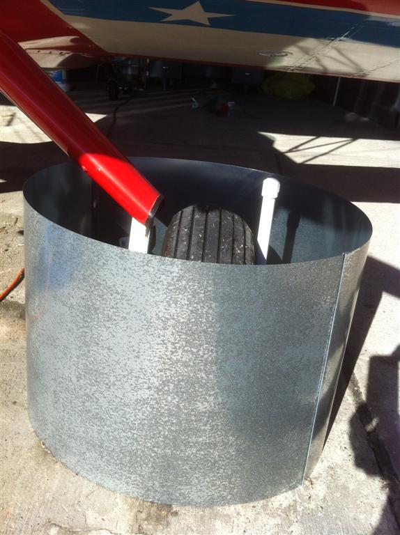

    If you want to keep mice out of your aircraft...I think the following might work. It might prove satisfactory to use a very smooth galvanized metal ring (collar) around the main gear and the third wheel should have a ring around it. If you have a taildragger the ring on the tail wheel might be quite large in diameter in order to clear the lower rear fuselage and any tail brace wires and the rudder. The height of the metal rings should be (safely) 19 inches although 13 to 14 inches might be enough for the average mouse...but not enough for competitors on Mouse Olympic teams.
    Properly designed rings should easily encircle the wheels and then clip together to form a complete circle. Where they clip together the joint should be very smooth and run vertically.

    The photos here show devices made up by Dan Hieronimous for his
    Marquart MA-5 Charger homebuilt biplane. They encircle the gear and clip together to form a mouse barrier.
    Name:  Joist Panning obtained at Lowes 16 x 24 inches x 3 for all three gear. (Large).JPG
Size:  80.3 KBName:  photo.JPG
