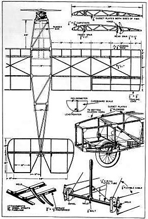

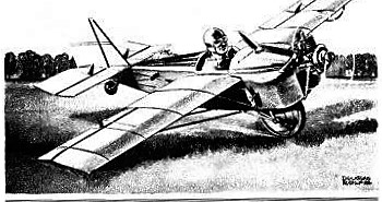

    I would definitely *not* recommend a "penguin" aircraft capable of even a short hop, which defeats the whole point of the concept, but I could see the benefit of a low-powered, completely non-flying tailwheel trainer with a cheap industrial engine to demystify tailwheel training and the dreaded ground loop. It would also be a fun project for a group of young people looking to learn basic aircraft construction without the stress and liability of a flying project. With a small industrial engine, just enough to get the tail up, I don't see what it would be any more dangerous than a quad or dirt bike, in fact, with a seat harness, helmet, and roll bar it would likely be much safer. You could probably get away with a pretty small diameter prop and even put a big guard around it if you really wanted to. There are complete plans including drawings by the great Douglas Rolfe in the 1932 Flying & Glider Manual.

    Thanks Cluttonfred,
    What I propose is to go electric with power to the wheel and eliminate the propeller. Add enough power and wing to allow short crow hops or at least to get light on the wheel. Max height is limited because as soon as one leaves the ground there is no more traction through the wheel. Max ground speed is limited by the motor controller same as is done with electric bikes.
