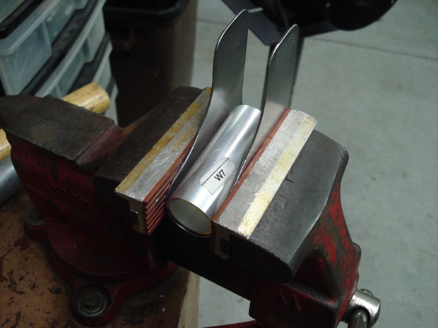

    I have been trying to decide how to connect the flying wires that are removable from the wings without turn buckles on both ends. (Note: the turnbuckles on the originals are on the lower ends of all wing wires only.)
    I looked at AN115 shackles, turnbuckles on both ends, making my own links to convert from the hole in the tang to a fork arrangement, custom made cables with inline swagged forks on the upper ends, or just suck it up and leave the cables attached to the wings. The shackles are pretty large and defeats the purpose that I twisted the tangs, I don't want to leave the cables attached, the custom cables are kind of expensive,, and making my own is just adding more time.
    Then Santa dropped in. My sweet wife said she would buy me the custom flying wires for Christmas Problem solved. I contacted Aircraft Spruce and they will add the ends to the cable I already have (saves about $80), so last night I cut the cables, leaving enough for me to attach turnbuckles on the other end and they are off to A/S today.

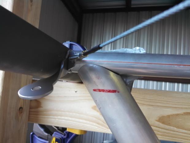

    Last weekend, after digesting way too much turkey, ham and pie, I started on the V struts. I initially mitered the forward aluminum tubes provided in the kit although I always intended to make the final struts out of wood.
    With the front struts where I could put them in general position, I attached the lower V strut attachment plates with clecos.

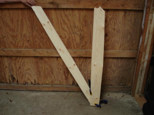

    I did not like the kit design for the rear strut attachment as it required it to angle forward a fair bit, but the original was vertical. I determined that the forward edge of the rear strut should mount under the rear spar rather the entire strut mounting in front of it. Also, I went to the hardware store to get some 1x6 pine to make proof of concept struts. Here it the initial layout.'
    At this point, I have to take them to the hangar and final fit them and mark the actual cut line where they attach to each other.
    By moving the rear strut under the spar, it results in issues on how to attach it. I have decided to make fittings that include straps that go around the spar and the ends bolt together along the lines of adel clamps. Just one more thing to work out.

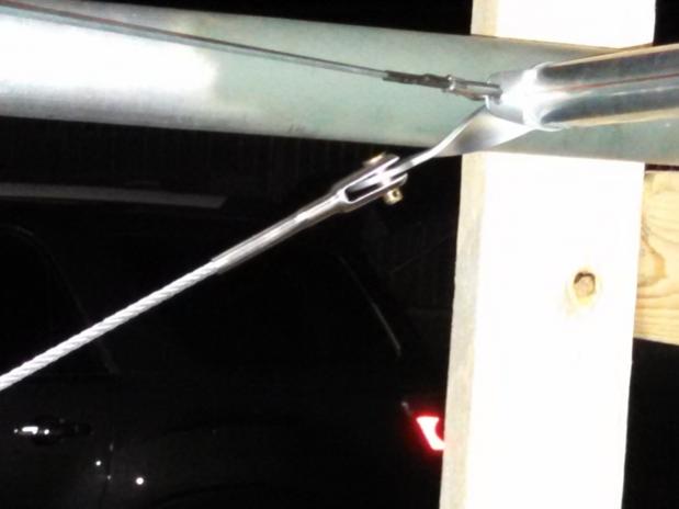

    Santa in the brown truck (UPS) brought me a present today - forks swagged on my flying wire cables.
    I now have flying wires - sort of. Sorry, they are kind of hard to see.

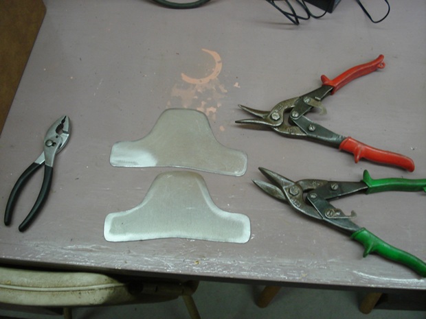

    Not a lot updated over the holidays, but I have "manufactured" the upper retaining straps for the cabane struts.
    These are from 16ga steel and gave me a fit cutting them out. I finally fell back on my air conditioning sheet metal hand tools, the grinder and sander.
    I'll post photos later.
    For some reason, the system cannot find the other photos of making these straps, so you only get this one.
