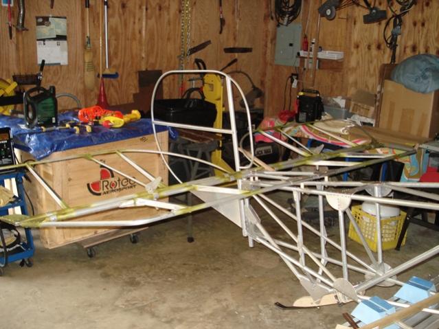

    Hi all. It has been a while since I posted here. The project is progressing painfully slow. Several reasons, but not unexpected.
    Since the last post, I mounted the rebuilt stab and elevators, pretty much finished the landing gear and just recently mounted the lower wing carry through tubes (after screwing up the first try and having to replace the carry through tubes and 3 fuselage members).

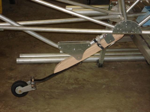

    Tail wheel set up and additional bracing to support it:

    More photos:
    Mounting the new stab and elevators:

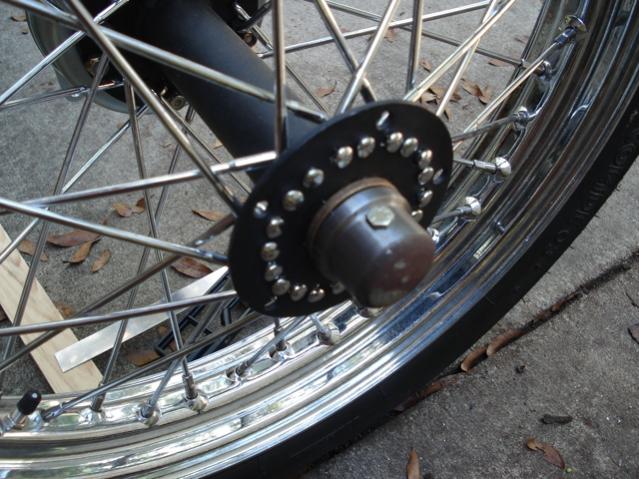

    Fancy axle caps made from pipe caps turned in a lathe:

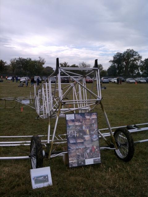

    Display set up at Dawn Patrol Rendezvous September 2014;
    My guard - Dad

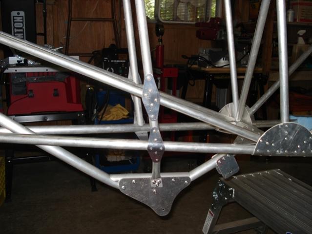

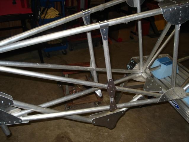

    Final set brings up to date:

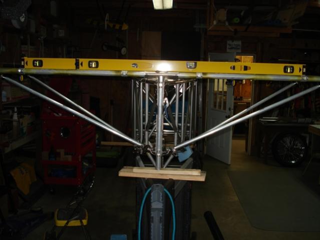

    My design for better forward cabane strut mounts:
    With larger front cabanes, I wanted larger rear also, but the top must fit between spar mounting plates. How I worked that out:
    Fancy jig set up:
    Spar Plates attached:
    Cabane structure basics in place:

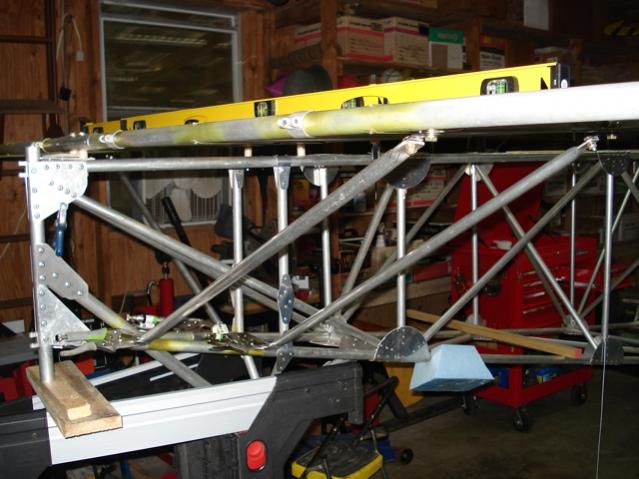

    Lower wing and cable carry through tubes mounted:
    That's where it sits today. I have a hangar at the local airport where I have the wing internal structures waiting for me to bring out the fuselage, jig it up and start fitting the wing structure to the fuselage. Due to work issues and planning to go to a fly in at Gardner Kansas in a few days, work will be pretty much a stand still until July.

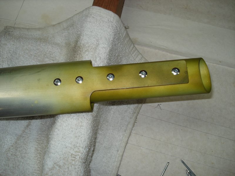

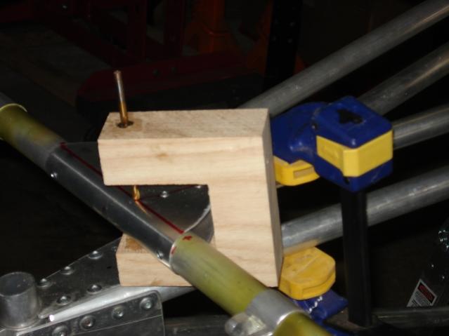

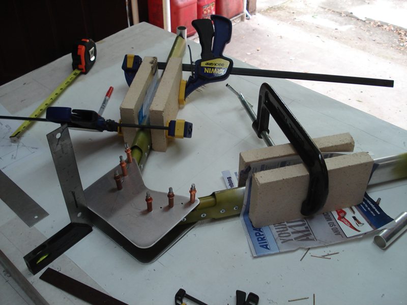

    A couple days ago, my son (visiting from Seattle) and I decided it was time to cut the stainless steel tubing for the spar connectors. I decided to go this route rather than the flat steel bars provided in the kit.
    The SS tube has to be cut and welded at the angles to match the spars. The top is easy. The top wing has a combined 7 degree sweep between the wings, no dihedral. So a 3.5 degree cut takes care of each side. The bottom is more difficult as it has each wing plugs to a carrythrough tube at 3.5 degrees back and 2.5 degrees up. Although, I can set my saw for both angles, my wife Rose and son Rob, both math wizards decided to find the angle for a single angle cut. They came up with about 4.25 degrees, or 2.13 for each part.
    To help weld them properly, I made welding jigs from 2" angle iron. I plan to take the parts to the local college welding shop where they have a world class welding school and the instructor comes highly recommended. I don't have the skill or equipment to weld stainless steel.
    Here are a few photos cutting an fitting the parts:
    Fitting the jig angles:
    Welding the jigs:
    Rob helping to cut tubing:
    Cleaning up the ends:
    Checking the fit:
    Ready for welding:
