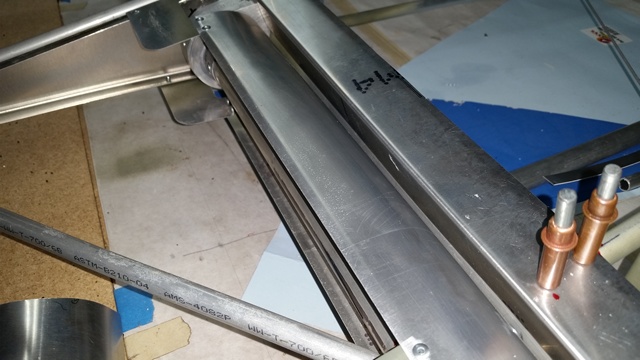

    Trailing edge fairings started. I decided to go with 2 piece top and bottom.
