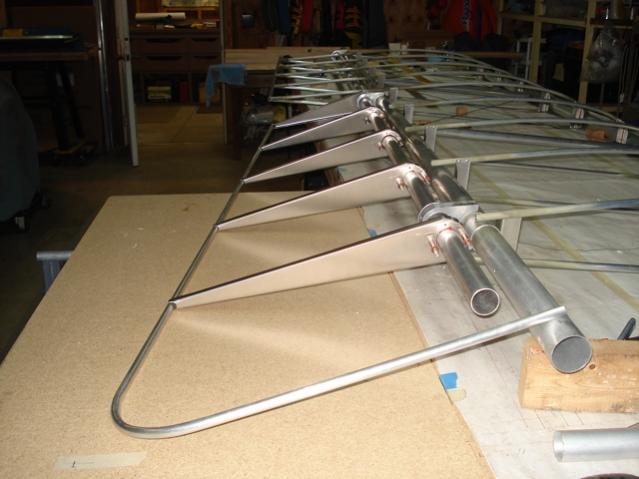

    Continued working on the right aileron. All ribs are formed and slid on the torque tube. The inner rib was lined up with the control wishbone and riveted in place. The remaining ribs need to be lined up with the inner rib, then riveted in place.

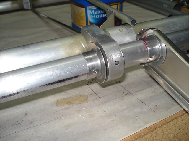

    I used extra aileron attachment "top hats" as stops to set the position of the torque tube. Here is the one inside the outer hinge. I set the end play movement to about 1/32" You can't see it in the photo, but the delren bushing in the hinge has a flange the stop rides against. No metal to metal.
    Once the ribs are lined up and riveted to the torque tube, then it is on to forming the wing tip bow, then forming the ends of the spars to meet and hold the wing and aileron tip bows.
    Dale

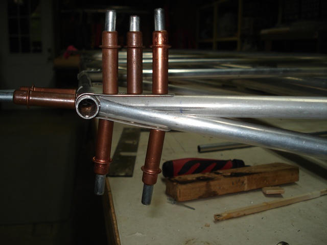

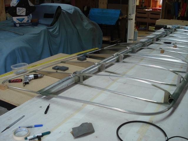

    Aileron ribs have been permanently attached and work on the tip begun.
    First bend of tip bows. 3/4" aluminum tubing.
    Forming mid-airfoil curve using the TLAR method of alignment.
    Not too bad!
    Drilling for the attachment to the leading edge.

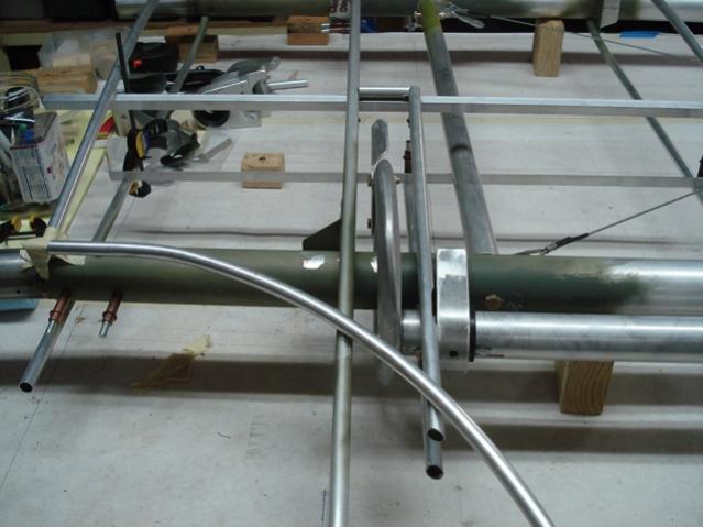

    Inletting the spar for the bow.
    After annealing, the tip was squeezed to taper to the tip bow.
    The aileron spar was subjected to the same treatment and here is the test fit.
    Moving slow, but moving.
    Dale

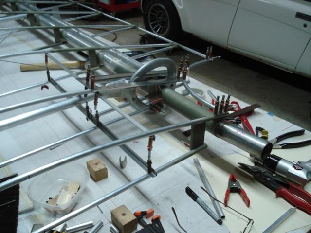

    I was unable to post photos for a while, but that seems to have cleared up.
    I have completed attaching the wing tip, aileron and main trailing edge.
    Name:  m_DSC05446 - Copy.jpg
    I have started the work on the root end, pilot cut out and box around the aileron control wishbone.

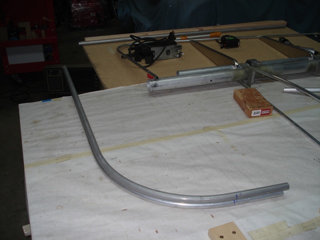

    Progress on the root area.

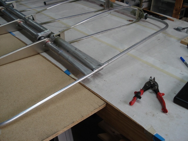

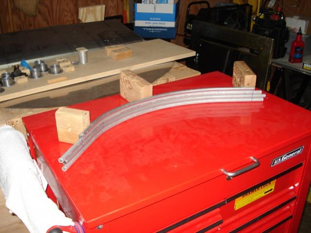

    Before fixing these parts, I needed to duplicate the pilot cut out bows.

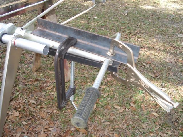

    I used these hi-tec forms (including the time) to make the bends.

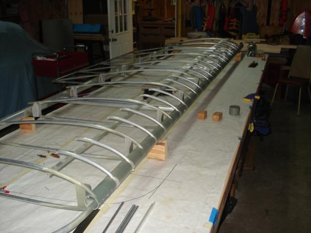

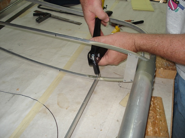

    After listing the remaining projects to complete the upper right wing (a longer list than I hoped), it was decided to start on the false ribs. There are 19 per wing and end up about 9” long. Bending that short of a tube is difficult, so we started out with 16” blanks. That was still tough, but a lever bar helped. Last Sunday we attached all but one false rib to the upper right wing.

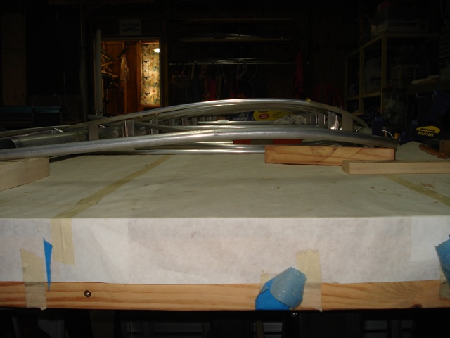

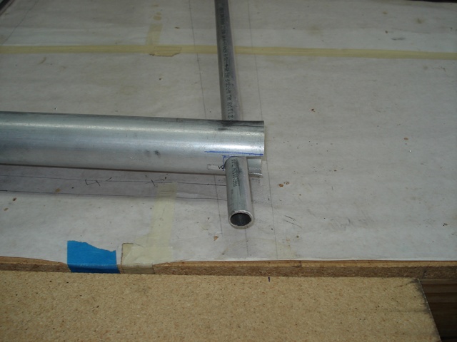

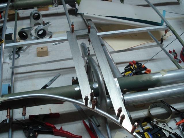

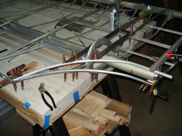

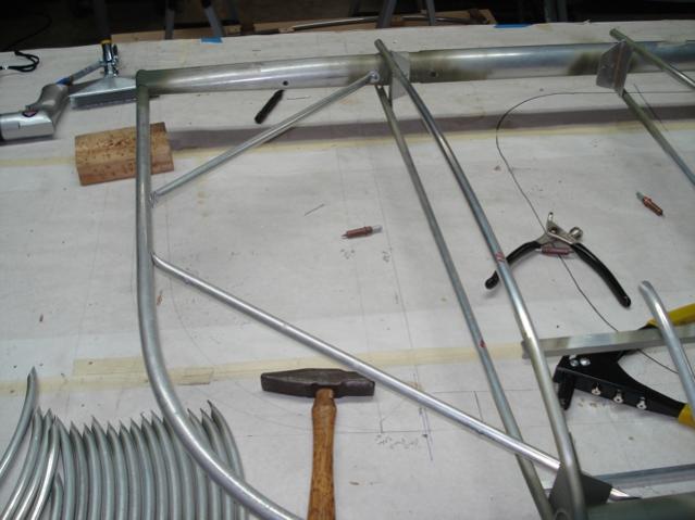

    Last weekend, we flipped the wing and started on the lower pilot cutout bow, wishbone opening framing and surround and root rib area.
    As usual, what Robert Baslee can do in 10 minutes took me several hours. Getting the angle cuts on the mating tubes took me forever with a file and sandpaper.
    We did manage to get the framing and surround for the wishbone complete and moved ahead on the root.
    However, since there is a plate that attaches the spar to the rear cabane tower, the lower cutout bow has to be cut off about 6" from the root (red line on spar in photo). This generates a lot of head scratching, but I have decided to sheet the rear 6" or so from the root rib to the second rib with thin aluminum leaving a permanent opening for the plate and access to the center spar nuts. For access to the front spar nuts, I will embed an aluminum surround in the covering, then attach a small aluminum access door.
    By the way, the aluminum angle at the root in the photo is just for alignment and not part of the wing.
    Dale
    Dale Cavin
    Florida Panhandle
  10. #110
    Hey, neat - you made two bows for that spot, a top and a bottom.
    I just went with the one.
