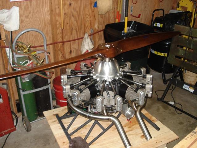

    Before starting on the lower ribs, I had to test the fit of my propeller to the engine hub. Nice.

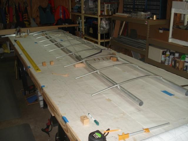

    Took a break from trimming the ends and brought one lower wing structure from the hangar to set the rib spacing.

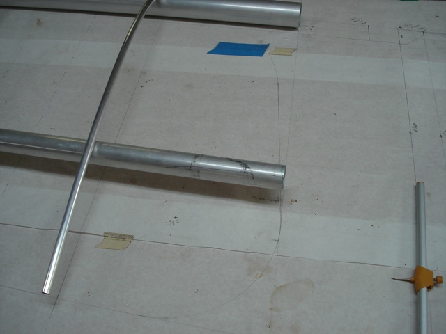

    Also laid out the tip lines per the Rosendaal drawings.

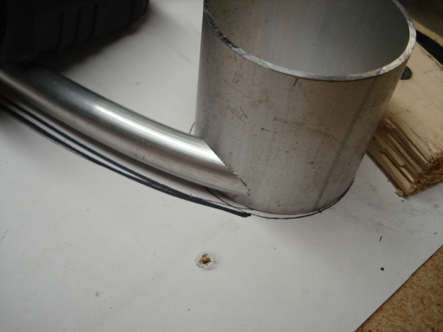

    I was having problems with drilling the arc in the tail of the rib. 1/2" step drill through 1/2" tubing wanted to catch just as the cut finished. This evening, I changed the blocks to oak and made them snug. I used a step bit with about 10 steps (max 1/2") at high speed in the drill press. Finally, I made the final cut through real slow and stopped the bit before I let it back up. Worked real good.

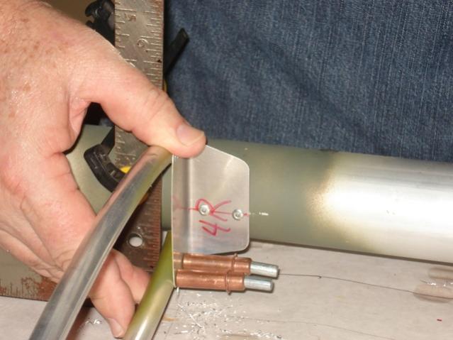

    All of the lower wing rib sets have been fit with the spar attachment brackets:

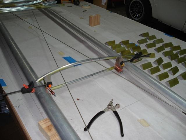

    Trial fit:
    I made one set with tabs pointing left and one set with tabs pointing right. All are clearing obstacles except the one just outside the inner compression strut. It had to be trimmed:

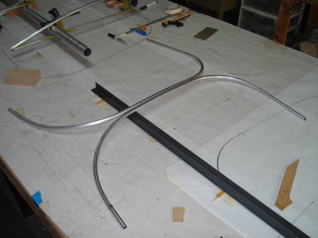

    Then it was on to forming the wing tip bows:
    Mirror image for the other tip:
    Lovely assistant holding tips for comparison:
    Next is to form the rear spar tips to a taper down to the 1/2" tip bow.

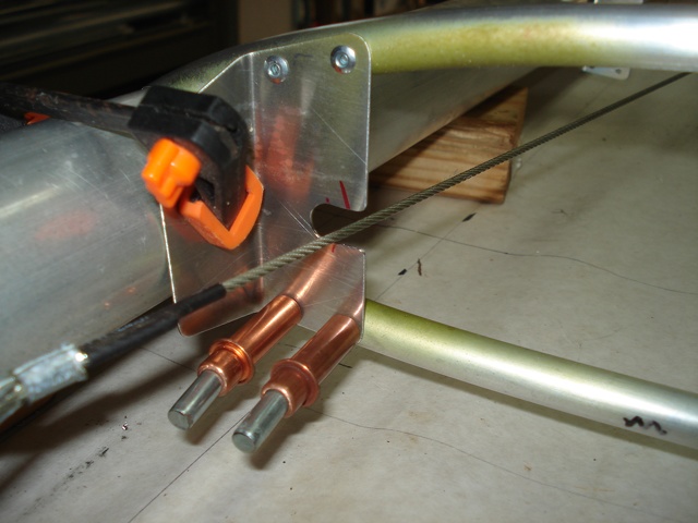

    After a lot of sweat, moaning, groaning and some pain, one wing tip is basically attached.

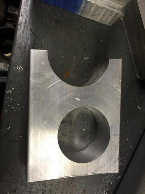

    I sent the material and drawing to my dad to machine the aileron blocks.
    He found it best to cut the holes by turning on his lathe.
