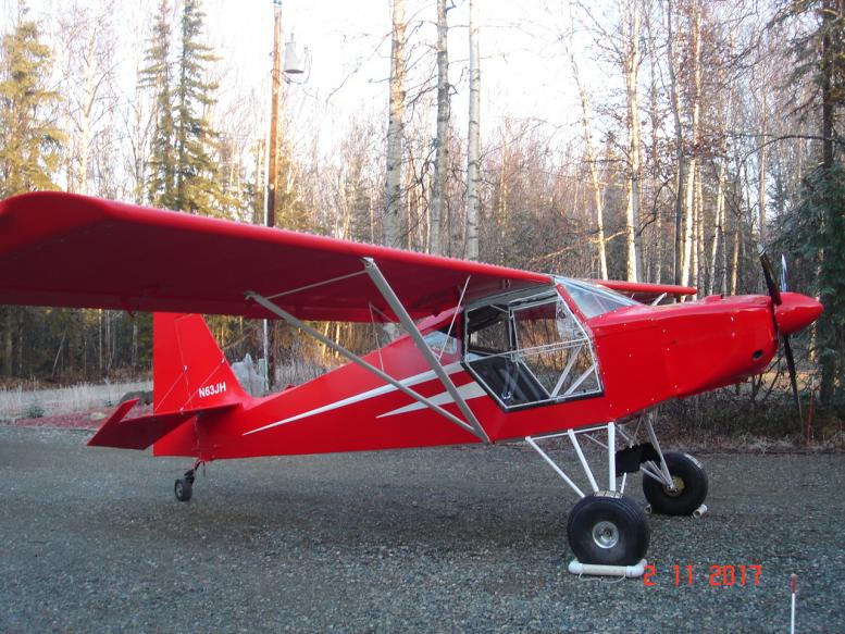

    Nice looking panel. Whatcha building?
    Thanks. It's a Just Highlander. Received the Airworthiness Certificate in November.
    Nice airplane! Clever wheel chocks, think I will borrow the idea.
    656
    I made some just like those. Nice thing is, they break down for stowage in the plane so they take less room.
