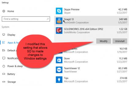

    Ok I got it fixed by doing the following:
    Name:  Line Resolutions II.jpg

    Glad you found a solution. I just looked for a similar setting in Win7 but I have not found it yet.
