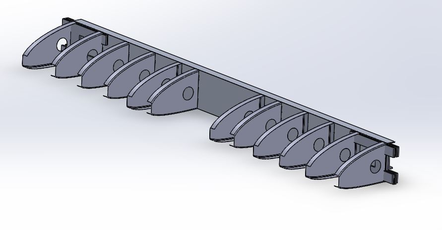

    I know this is nowhere near as complete as the Pitts, above, but it's a start. I'm new to Solidworks, but not 3d modeling. Right now, I'm just inputting a set of plans as drawn and will later go back and try to resolve any issues that don't solve themselves with more time and effort.

    Nice
    How did you enter your airfoil and where did you get the data for it?
  3. #23
    Dec 2012
    Connecticut
    38
    Quote Originally Posted by Jeffrey Meyer View Post
    Nice
    I got the airfoil coordinates off the UIUC Airfoil Data site: http://m-selig.ae.illinois.edu/ads/c...atabase.html#N
    Then I opened the .dat file in excel and scaled it with the chord of the airplane. I saved that file back to a tab separated .txt file with a z-coordinate of 0.
    I then followed the instructions on the site below for how to create a spline based on a .txt file:
    https://grabcad.com/questions/tutori...om-a-text-file
    Instead of scaling the file in Excel, there is also a scale option in solidworks under: Insert-->Features-->Scale. I found that after I'd already scaled it in Excel, but it is probably how I'd do it next time.

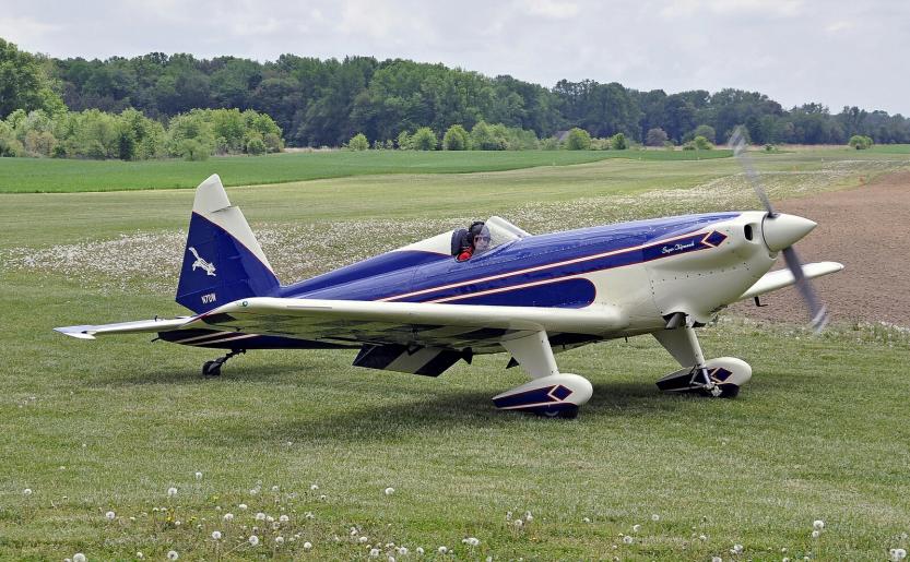

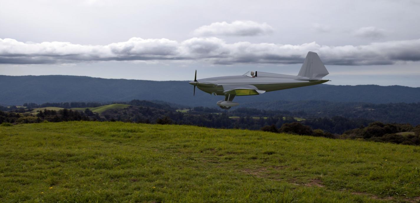

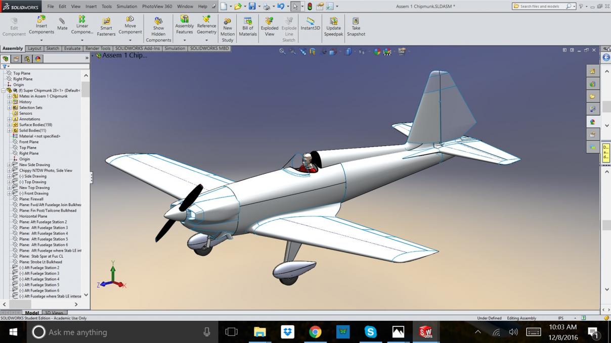

    All, I posted my Super Chipmunk model in a different thread and placed it on GrabCAD, but figured I'd put it here too. I've only been at this about 3 months - no prior experience with SolidWorks or any kind of CAD. I'm modeling my own airplane (which I rebuilt and modified so know it well) as a way to learn the software. Just learned about "render" and having fun with it.
    Very impressive Pitts, CWILLIAMROSE! I have only learned how to do external lofting so far. Next goal is to turn my surfaces and solids into sheet metal then how to build structure underneath it. I haven't found much on this topic so far in my SolidWorks text or videos, beyond simple sheet metal design. I'm awed by what you have been able to model, Mr. Rose!Name:  Chipmunk Render 8.jpg
