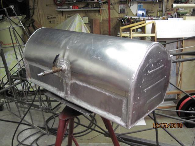

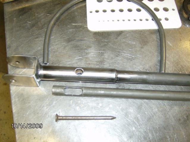

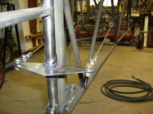

    Here's more pictures.

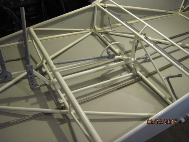

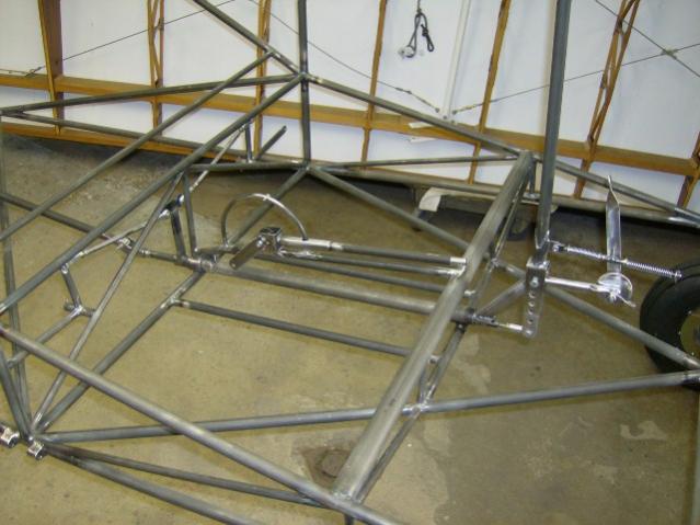

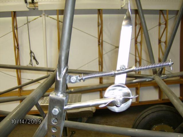

    These are the flight controls
    Mike

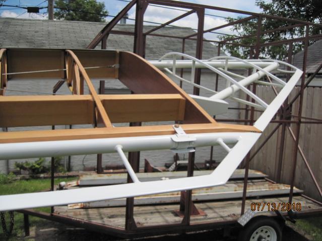

    More Pictures

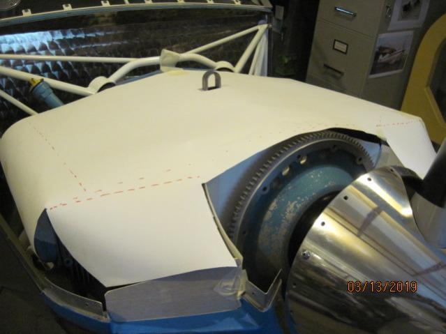

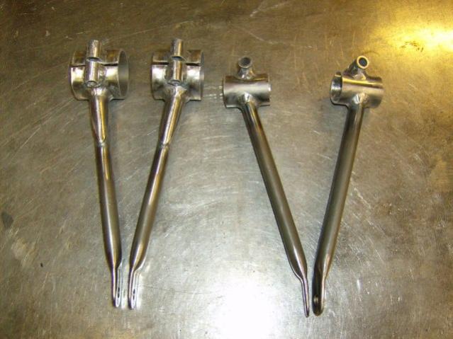

    Misc Pictures.
    Whoever buys it will get a Copy of all the building pictures...

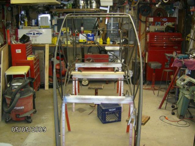

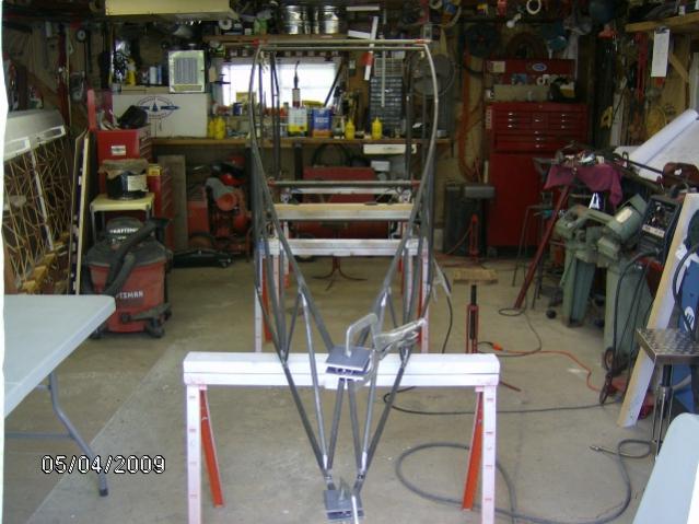

    Process for Welding the Fuselage...
    It helps Keep the Longerons from pulling in during welding.
    They are kept slightly outward for fabric...
    The fabric then pulls them in for a straight Fuselage.
    Learned this from Jim Clement.
    Mike
