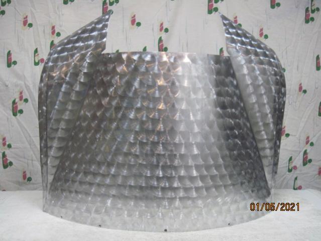

    Plenum Cover
    . The scars on the aluminum were hidden with some engine turning .
    http://www.wingsforum.com/viewtopic....18465&start=75

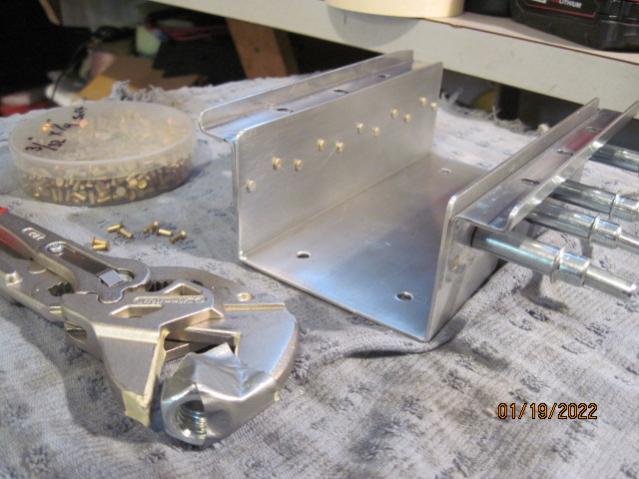

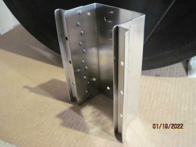

    What is this most recent part and why is a nut taped on the Knipix(sp?) pliers?

    This is an example of the Modification....I can JUMP a flange to squeeze a rivet
    Different size nuts work...I use two sizes so far.
    The tape has NO PRESSURE...It only keeps the nut aliened
    I thought of this during my Plenum fabrication
    https://www.wingsforum.com/viewtopic.php?f=320&t=18465&start=75#p54514
    PS Thank you for the complement....That's a new one
    OK - I turned a thick (1/2") die for the rivet squeezer to jump a flange. Works great.

    Meanwhile ...I just happen to see a picture with those knipex (?)
    The first way I was jumping a flange for riveting...The jump block was floating...it had to be held til pressure was applied.
    later I came up with using nuts because SIZES are easy to change,
    and they are held to the tool with a simple piece of tape, leaving metal to metal contact.
