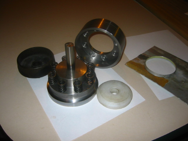

    Norman how did you get such deep lightening hole flanges. They are beautiful!!. What material.
    Joe Goldman
  3. #23
    Norman Langlois's Avatar
    Northwood ,N.H. USA
    180
    Joe
    A special compression die was made and is variable ,to create the flare in different size holes. as well as different flare. What you saw is the deepest and is done on 6061 T6 .050 . Its what makes my single spar what it is.Any less of a flare would not give the large diaphragm the strength of a truss work.Name:  flaring tl opn.jpg
    The die clamps the material before it coins it using a hydraulic press
    Also used is simply a set of Green lee Punches.carefully debured so not to have crack starting points.
