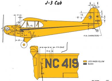

    There is a thread on the supercub.org BB on Cub marking. Wing N numbers were 24x16 with a 4 inch character. I tried posting a copy but I keep losing it.

    this is something I found and saved for future reference

    Interesting. What nearly everyone calls "Cub Yellow" is labeled as "Lock Haven Yellow."

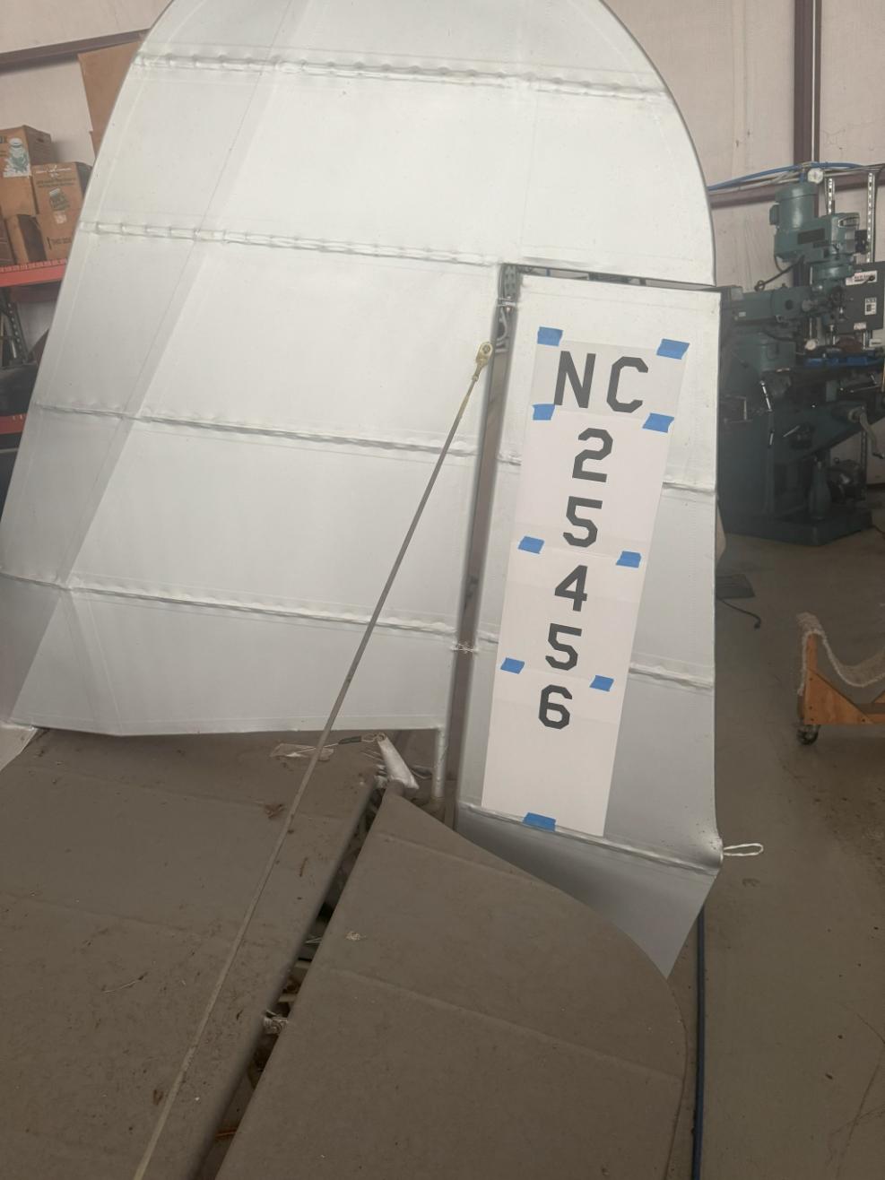

    I'm making paint masks with my vinyl cutter. What is the font typically used for vintage N-numbers. Back in the day they all seemed to use the same simple style. Should be easy but I'm lost in the morass of specialty fonts. This is what I'm looking for.

    Yeah, I'll probably not do the wing markings for that reason but I still want the right font for the tail numbers. I've found a font that is pretty close and may use it if nothing better presents itself. This is for sizing with 3" letters.
