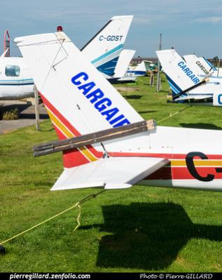

    I saw a picture somewhere of a rudder lock on some cargo planes that clamped the rudder to the VS wrapping around them about mid point. It is heavier and may not be the easiest to carry but I imagine a cargo company know what works.
