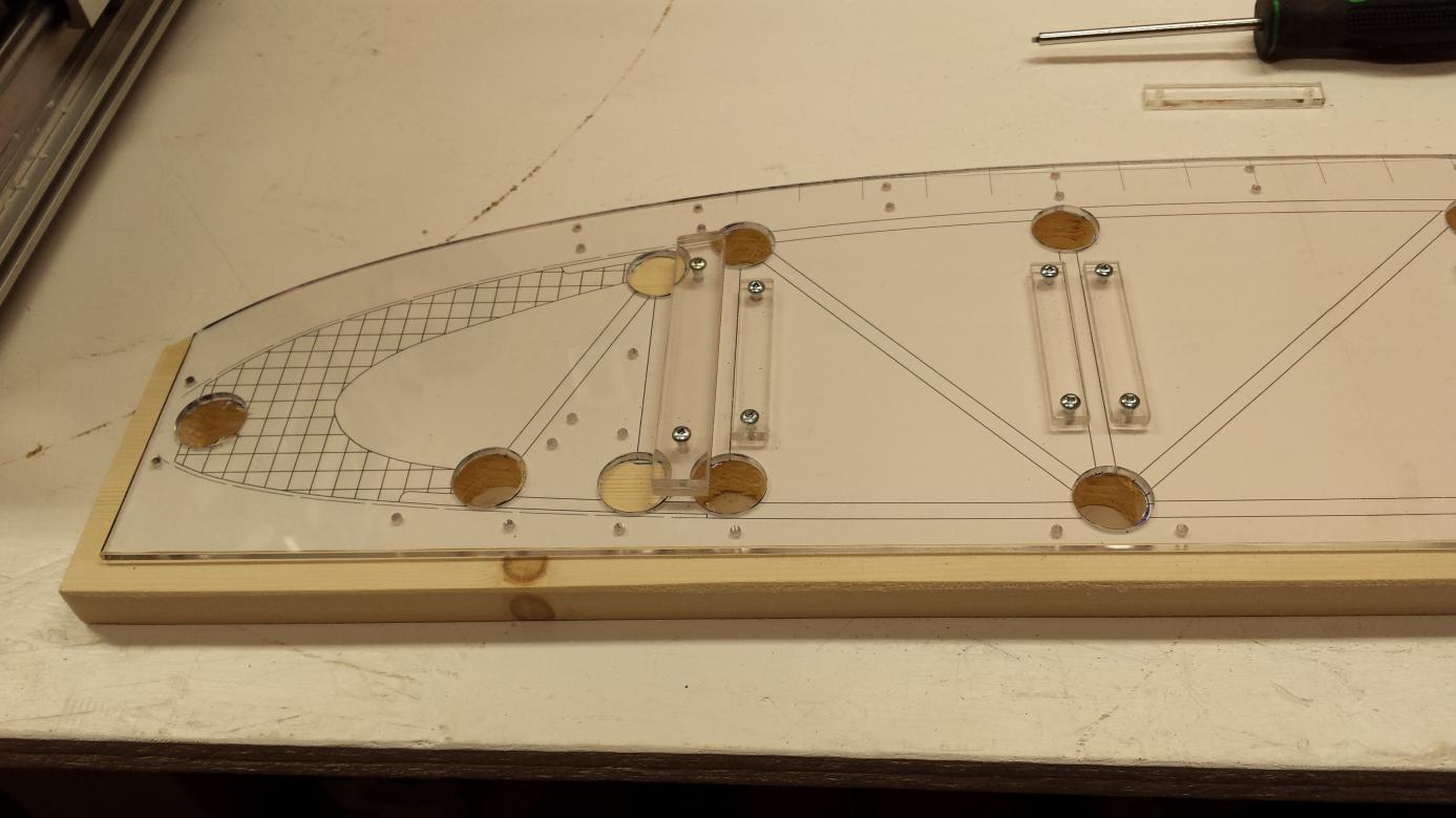

    I did the majority of my project with CNC. I bought a 6040 CNC router when I started the ribs. I had a local place CNC cut a plexiglass jig as my router wasn't big enough. The local place was happy to do the plexiglass jig. I know another place that will CNC laser cut 4x12 sheets of aluminum no problem. I'm not sure why the holes need to be punched.
    I did all the small plexiglass parts and all the wood rib parts. For sure my ribs were accurate because of the CNC. Putting the rib jig together was just a matter of assembling the parts in the pre drilled holes.

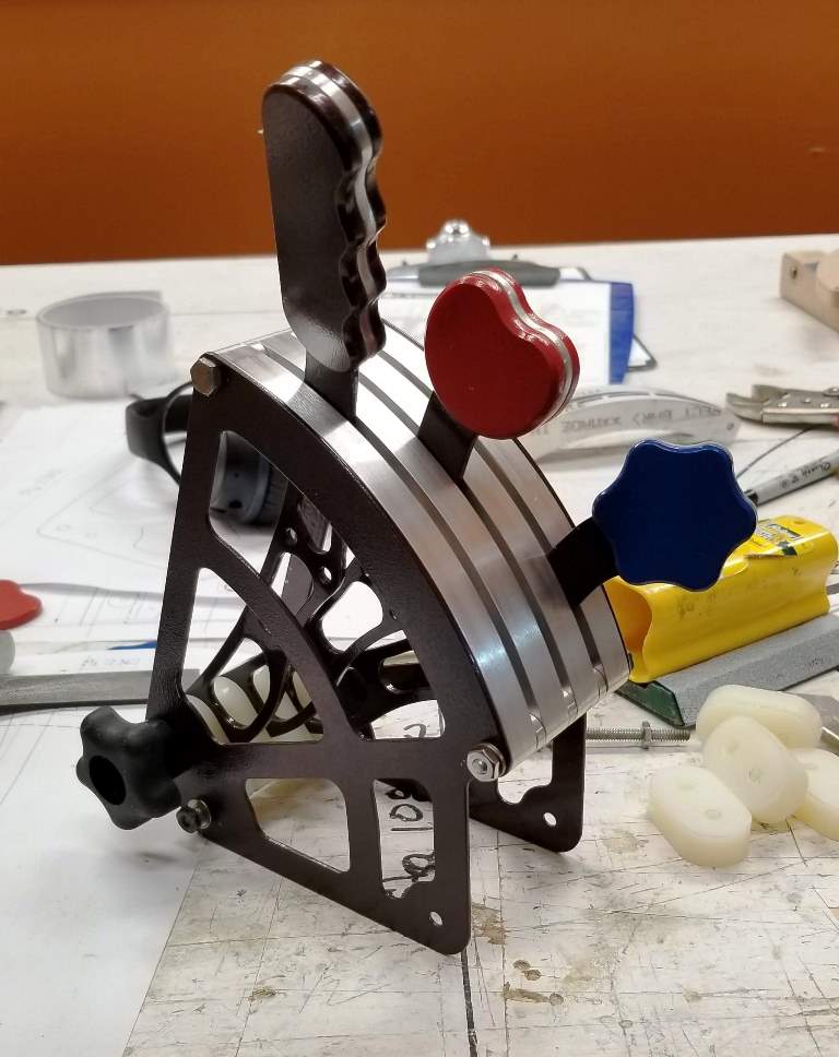

    I also had all the metal parts CNC laser cut locally. My CNC router can't cut 4130 steel. All of the stuff I outsourced was from the DXF files I supplied. They did the conversion to gcode and optimized the parts on the material I supplied. The cost was a few $ per part. Money well spent.

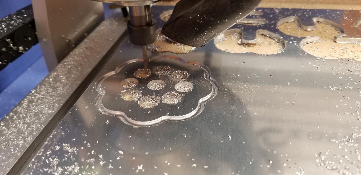

    I recently learned how to cut Aluminum with my CNC router.
