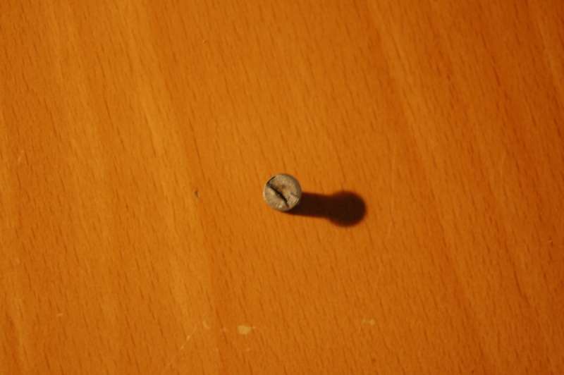

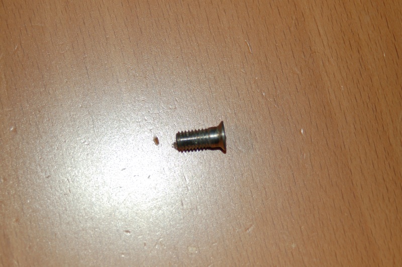

I need to find 88 of these little suckers:
It's a Hi-Torque coin-slot style screw. It's threaded 10-32 and is about .45" long.
The head is the important part, the diameter is about .272-.273 according to my Harbor Fright caliper.
The head diameter is different enough that I can't use regular 100 degree flat head screws. The holes in the trim section I'm repairing was countersunk for this exact screw.
The replacement screw doesn't have to be a coin-slot screw, but it would be nice.
Any suggestions? Aircraft Spruce & Wicks do not seem to carry them.
