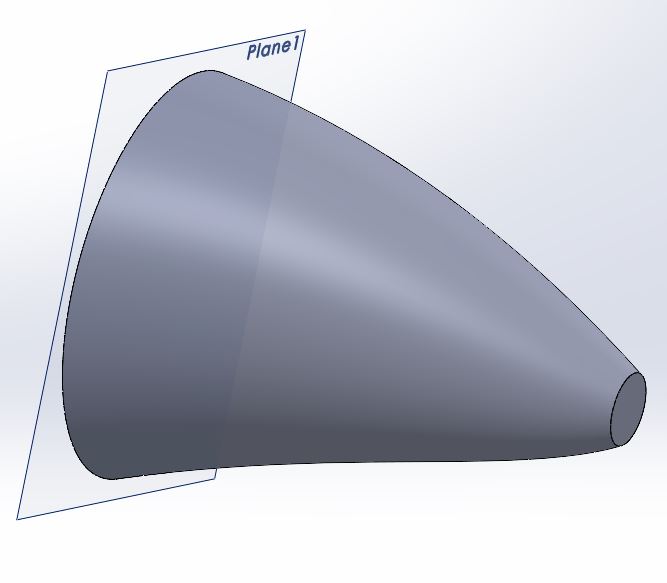

    I'm trying to draw a rocket nozzle in SW. These aren't, of course, simple cones, but have a tapered shape.
    I start out with circles defining the base and exit.

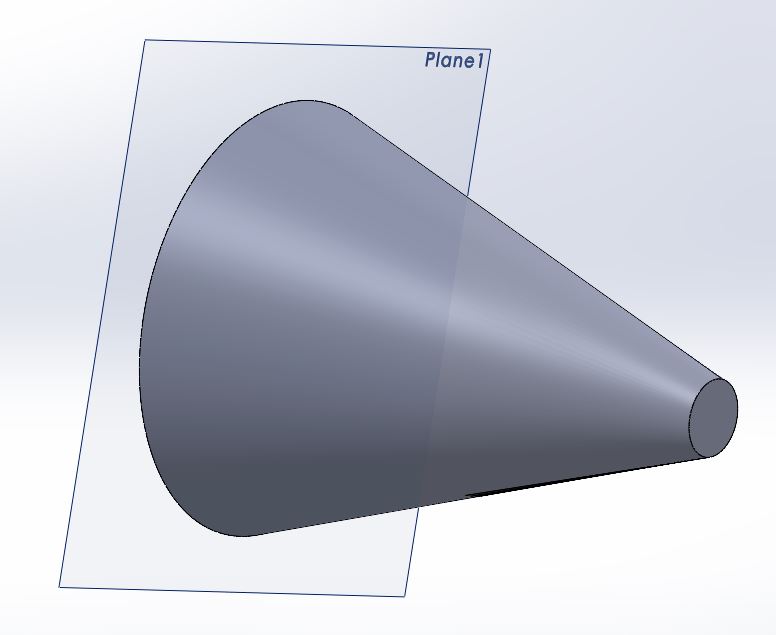

    Seems like I should be able to define the outer shape of the nozzle using a guide curve...

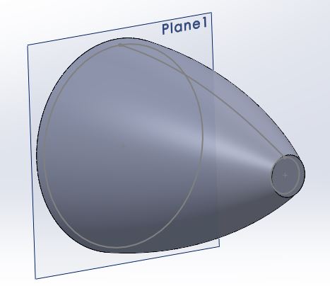

    But...when I do, it limits the guide to only the portion of the cone directly by it....

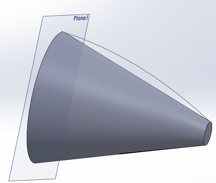

    Now, it works fine using Revolved Boss/Base...I'm just curious if there's a way to rotate the Lofted guide lines to define a regular feature. Seems a bit simpler.

    Hi Ron.
    Method 1: Loft a segment of the cone (say 30 deg.) using two identical guide curves. Then circular pattern the segment into the complete cone.
    Method 2: Loft the nose cone without the guide curve, while setting the end condition of the larger circle to "Normal to profile".
    Method 3: (Not recommended!) Loft two identical guide curves as profiles and use circular segments as guide curves - then circular pattern the body.
    The last one is a bit like trying to boil the sea
    Jeffrey

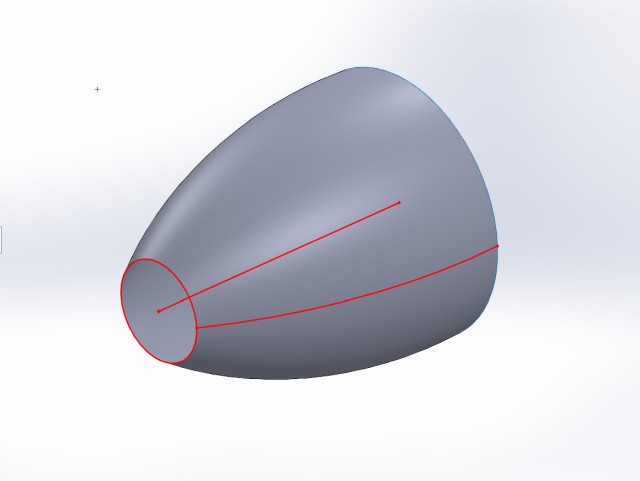

    To me it seems that you can't make it accurately by lofted or boundary surface. However, besides revolved surface you can use swept surface. Then you can't dimension the circle, but it must be connected with the guide curve.
