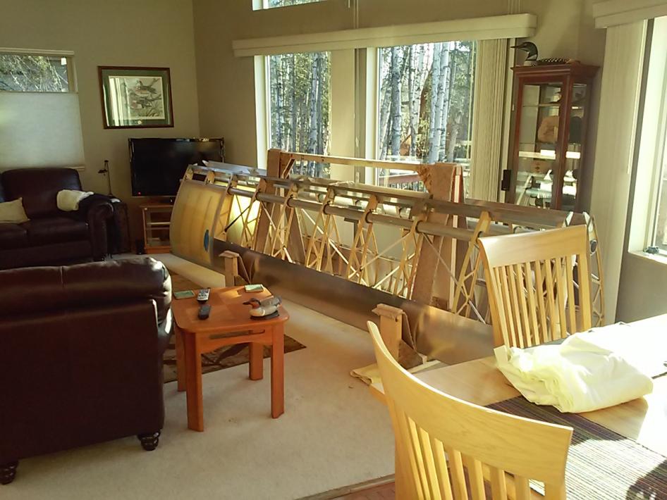

    This is another wing storage option, especially for those that find themselves working on their plane more than watching TV.
