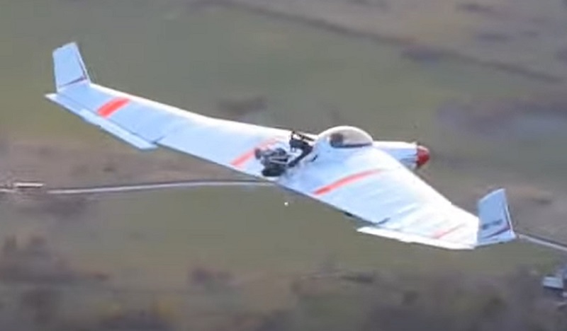

    Then there's the Mitchell U-2 Superwing ultralight. https://en.wikipedia.org/wiki/Mitchell_U-2_Superwing
