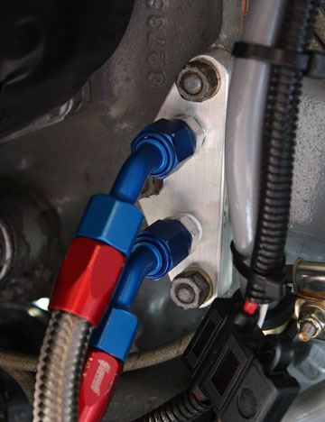

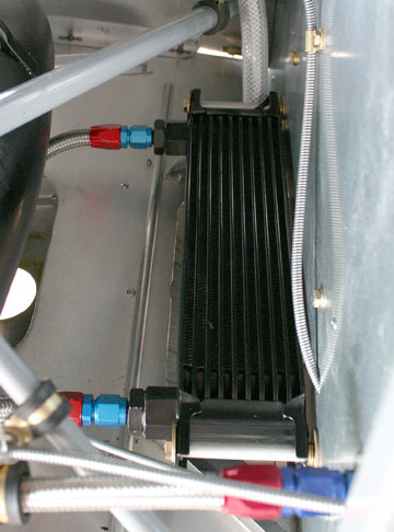

    The O-200 installation in the C-150 has a "tray" that directs airflow across the bottom of the engine case and extracts heat from the oil. Most likely your installation doesn't have that tray. I ran into this situation when I install a C-150 O-200 in my Fokker biplane and had excessive oil temps. The solution was the addition of an oil cooler and that solved the temp problem even n very hot days.
    My cooler is plumbed into ports that are most likely used by your oil filter adapter. But if your filter adapter is indeed "remote" then you could insert a cooler into the filter hose loop. The O-200 needs oil cooling of some sort in a closed cowl. Here is the adapter I made for adding the cooler to my O-200:

    And the cooler on the firewall:

    Sam Buchanan
