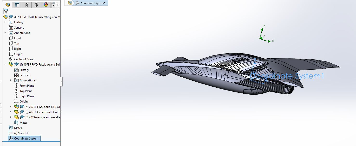

    You can see the CG (Black and White 'BMW' Circle), the 'Local Coordinate System' (GREEN), and 'Coordinate System 1' (BLUE) in the first image. Coordinate System 1 is where I want the CG. I created the location, and added the axis, for Coordinate System 1.

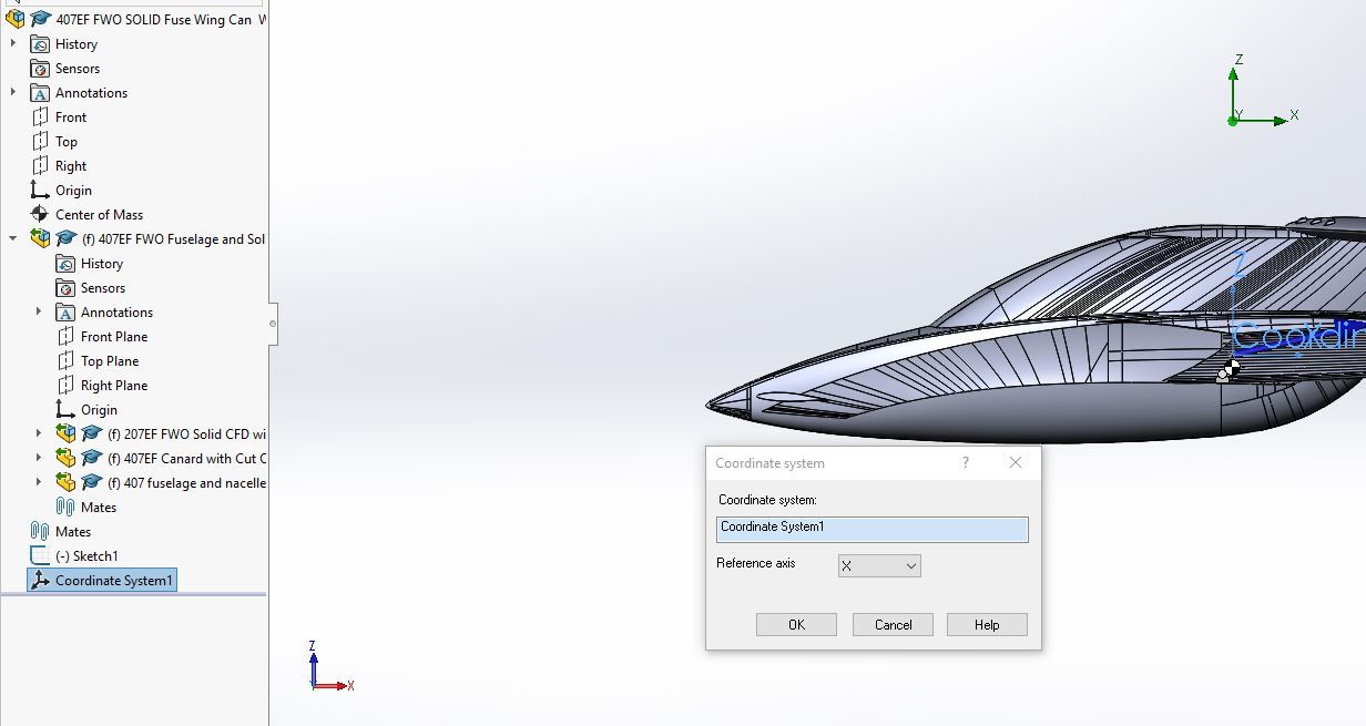

    The second image shows the 'Mass Properties' menu. Note the 'Override Mass Properties.' That is the 'button' that needs to be selected, not the Recalculate. Also note that the 'Report coordinate values relative to:' has my Coordinate System 1 selected. Very important. You select that from the tree (see 'Coordinate System 1 in the tree, top image. It is highlighted). Also note the CG/Coordinate System 1 is rotated counterclockwise, it seems. That is because the 'CG' has gravity acting through it. The image 2 (and the other images) are calculated at an AoA of 13 Degrees (see the very top of the image 2 and you will find the file name for this calculation. Note the 13 AoA in the file name) . The X axis of the CG (PINK Coordinate system, which is also the CG and Coordinate System 1) is rotated 13 Degrees counter clockwise.
