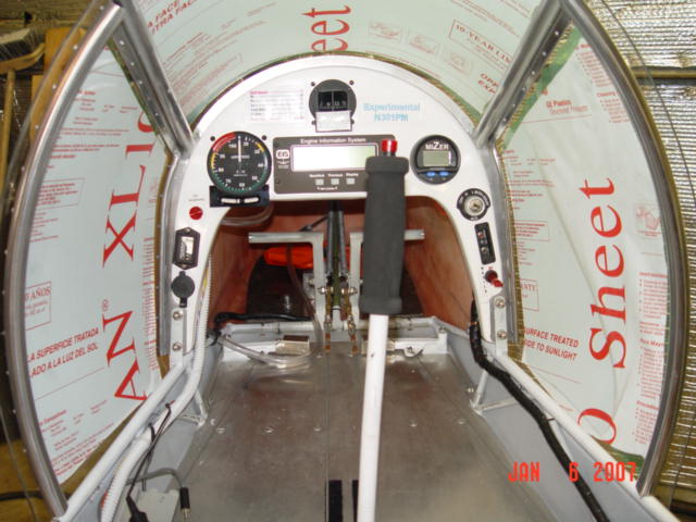

    Fly with or without doors...
    One main door , the other side will be an emergency escape .
    I have water at one end of my runway , I've heard Kolb owners complaints about
    the possibility of being trapped .
    I haven't started on that side yet ...
    Might be getting Full Lotus later
    Here's the link to the Log...and I'll put a few pictures below
    http://www.wingsforum.com/viewtopic....=4308&start=15
    Brrrmidji , Minne-SNOW-ta
    218
    I took a picture from the same angle as I had before the enclosure ...
    It's hard to tell the difference
    218
    Finishing up with the lexan...
    The escape door is secured
    maybe a piece of styrofoam under the spring.
    The foam in the picture was replaced with a smaller one .
    The door latch has a "stop"...its !/2" stainless steel rivet with an aluminum sleeve and nylon washer
