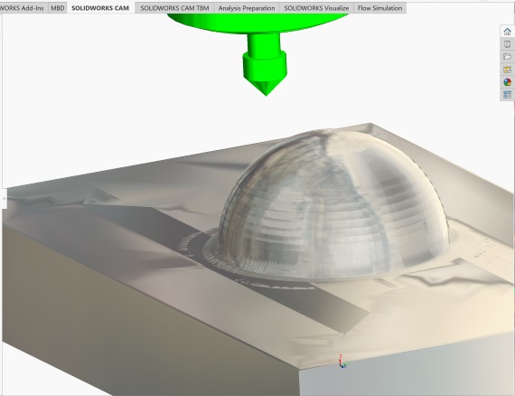

    No HSM on this workstation. What took Solid Cam 3 toolpaths, multiple tools, re adjusting the wizard and toolpath order to recreate what I could do in MasterCAM in one with only a 1/4 endmill. This was with having pause on any collisions. Both only 3 axis.
