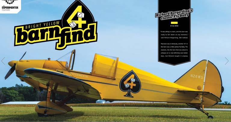

    One of the neat things about the Fly Baby is that cosmetic changes, to make it look like other aircraft, are fairly simple. The May 2018th issue of SPORT AVIATION had an article about Richard Borgerding's Fly Baby, which has a canopy and a raised turtledeck.
    Name:  borgerding fly baby p-40 turtledeck.jpg

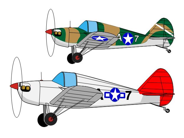

    Right from the start, this looked to be a good layout for a fake P-40. One could be painted like the original Tuskegee Airmen P-40s, or a "Red Tails" paint job could be applied.

    Thanks so much, Ron... what a great place to start my search. I especially like the idea that we adopt the "red tail" of the later P-40s or the paint scheme of the original. That would be a wonderful choice for the teens to make! The fact that there is so much material in support of the build is another plus. My first wooden boat build was supported by a great book that had been assembled from a series of articles. Boy, do pictures help focus one's vision!
