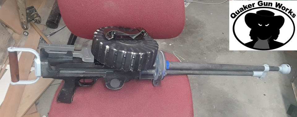

    Well, here's the "amorphous blob" integrated into the main project. This is a full-scale, non-fireable wooden/plastic replica of a WWI Lewis Gun. Picture was taken during the final fit check prior to finishing. The main receiver, the barrel, and the gas tube (below the barrel) are wood, nearly everything else was drawn in Solidworks and printed on my 3D printer. I've learned a LOT on how to run Solidworks, now, though I've still got a long way to go.
    BTW, a "Quaker" in armaments lingo is a dummy wooden gun. Hence the logo.
    The drum is from a commercial kit sold by https://www.foxflier.com/lewis/, although I did my own handle.
    Hardest part is getting a metallic sheen on the wood and plastic. In the past, I've painted it gloss black and then sprayed it with matte finish. A product called "Rub N Buff" can be used on corners to simulate wear...that's on the drum, in fact.

    And...project completed. Learned a lot about Solidworks this way.
    Name:  lewis gun combined.jpg
    It's about three pounds of wood and plastic.
