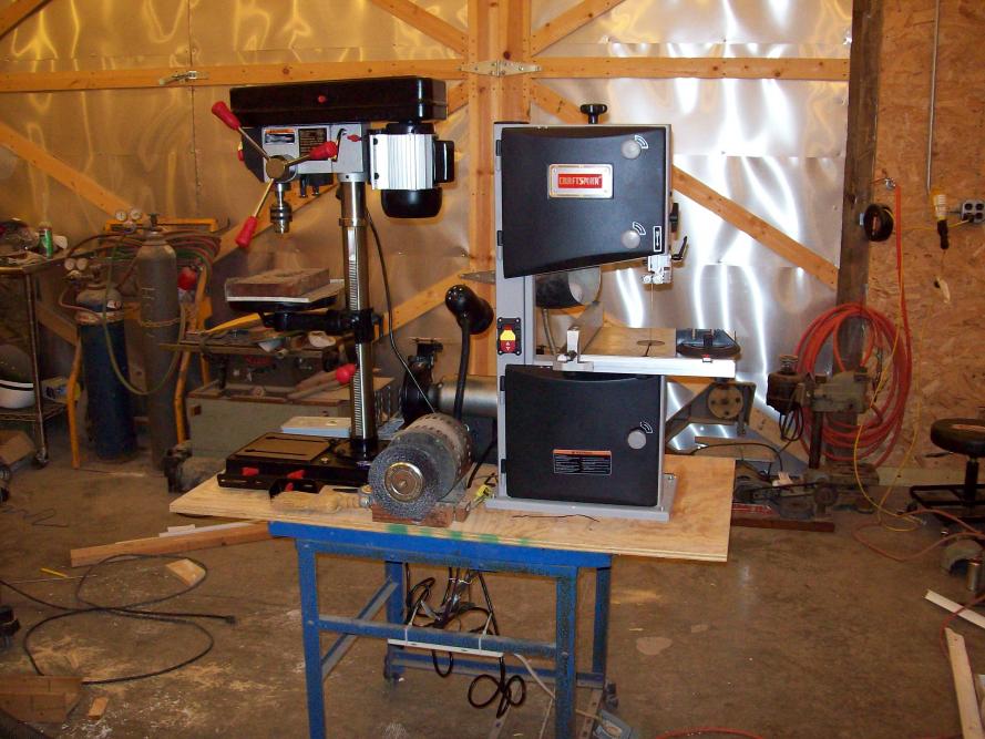

    Putting several bench mounted power tools on a table on casters can help a lot with freeing up space, it can be moved against a wall when not being used. I mounted this on an old table saw base.

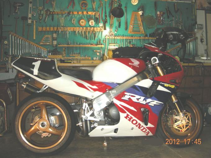

    Busy Little Shop is my garage built around my Lathe and Mill... I used wood and nails to organize my tools...
