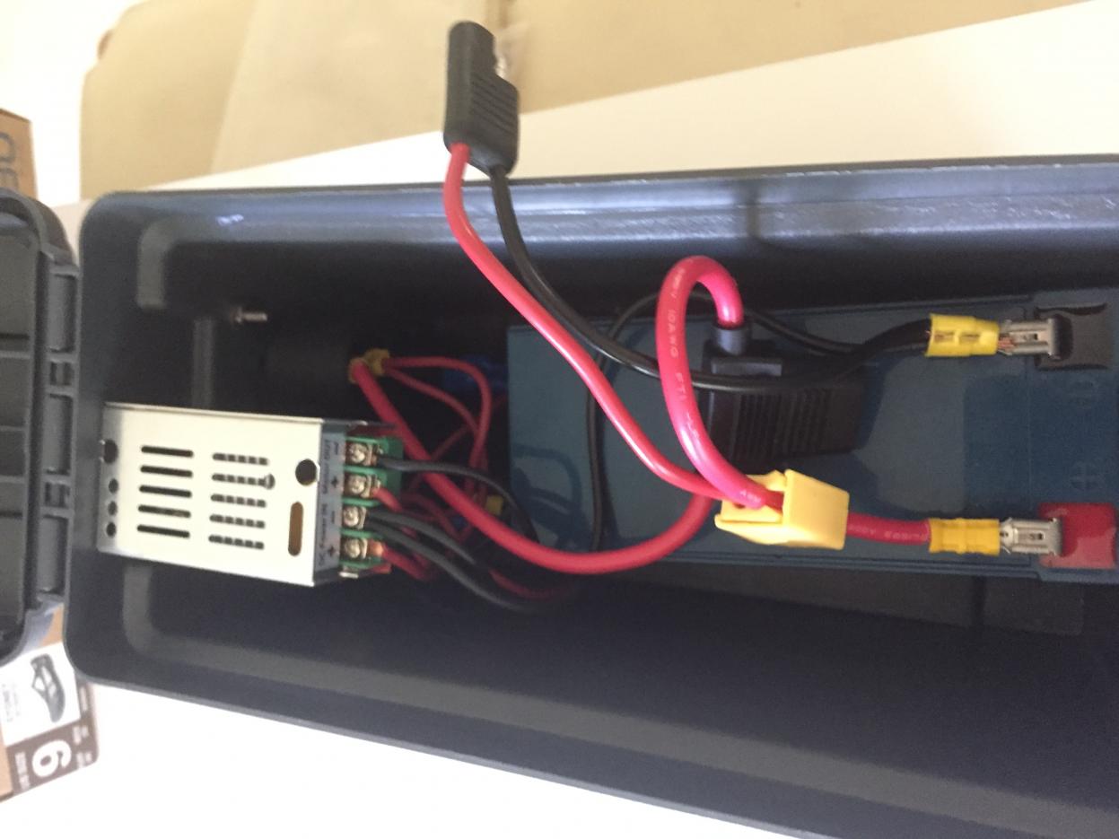

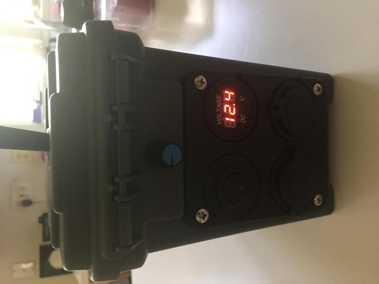

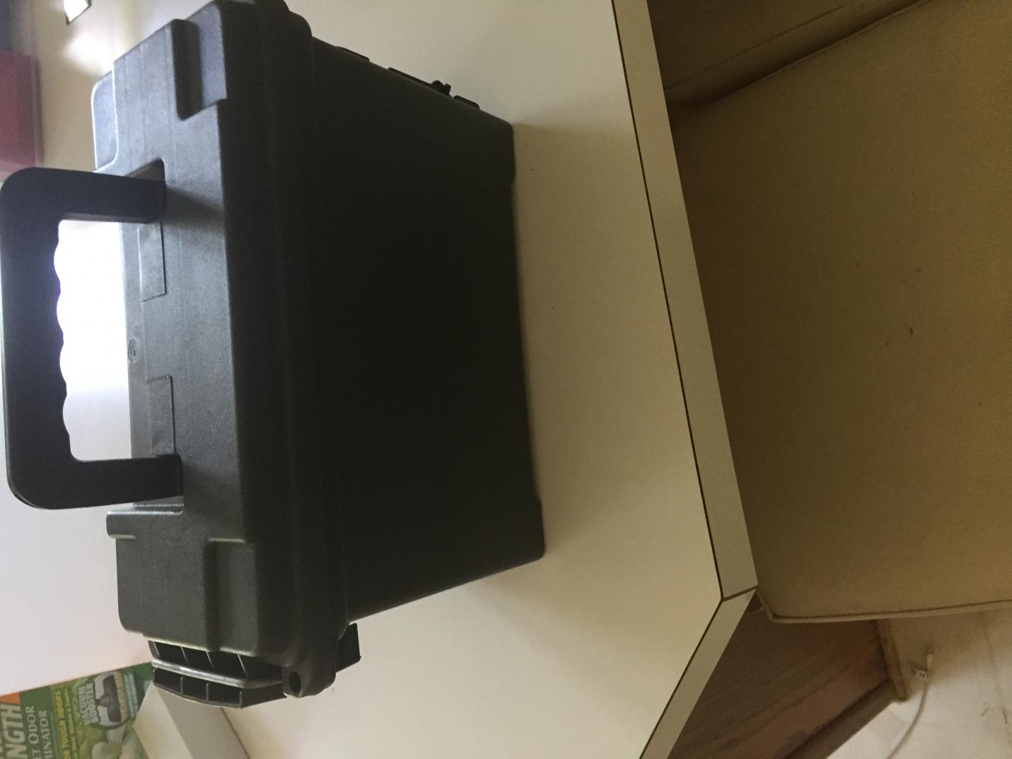

    I made a 12v power pack to take on camping trips. I got a 12v SLA 14AH battery about the size of a motorcycle battery and installed it in a Harbor Freight ammo box. On the front I added a 12v power outlet and some 5v USB ports. You can find those on Amazon or Ebay fairly cheaply. I also attached an SAE quick connect connector to the battery which I can attach to a solar panel for charging during the day and using the battery at night. I have a folding 100 watt solar panel.
