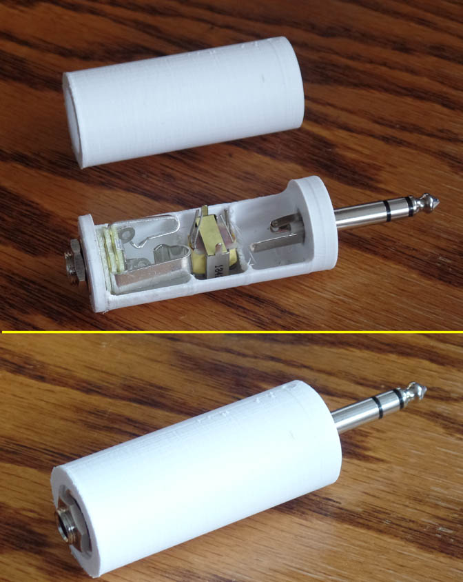

    Assembled...but not wired...unit, both open, and with the outer shell in place.
    I'm thinking about making one 1/8"=1/4" longer, to make wiring a bit easier.
    For those wondering, when you are using an aircraft headset on a handheld radio, this adaptor increases the headphone sound level by 6 dB (doubling the volume).

    I'm not that fired about this design because it cantilevers off the instrument panel; don't like the way loads are going to go. I'm working on a more-squat design.
    Can you mount it behind the panel, with only the jack protruding?

    [QUOTE=rwanttaja;79194Ron Wanttaja[/QUOTE]I'm not that fired about this design because it cantilevers off the instrument panel; don't like the way loads are going to go. I'm working on a more-squat design
    I have worked with all things audio for many years and saw this problem right away. You are correct to be concerned about the moment-arm weight from all this hanging on the 1/4" jack. By the time the actual headset cable and plug are connected there is considerable force. I don't have a guess about this force making for actual breakage, but it will make for internal connection problems. You likely know that there are factory-made transformer adapters just like this, for sale at any audio outlet (including Radio Shack if you can find one). But they are made of metal and much heavier than your SW design. I'm guessing that's why you are bothering to do this work. But the cantilever and significant moment arm seems dicey to me. I would try to design something that is a 90 degree plug.

    Yes, and the problem here is actually worse than it might first appear. I'm building this adaptor to get good volume from a Flightworks Denali ANL headset; as an ANL headset, it has a battery box on the cord about ~6 inches from the plugs. So the cantilevered design, if I just plug in the headset, is even worse with the weight of the battery box added.
    As you can see from the aircraft installation, I do have options. There's a small shelf below the headset jacks; it's where I used to clamp the battery box from the Denalis before I decided I needed more volume.
    I might actually build a little clip to attach the headset's battery box to the GPS mount (the disk-shaped thing just above the ferrite cores on the headset cable). That would take most of the load off a plug-type adaptor.
    I actually made a "long" version of an adaptor cable; ~3' of cable terminating in a box with the jacks. This works, but there's too much cable. Might do a short version that attaches to the Denali battery box.
    This is a nice casual project. In the summer, I use 8-ohm ear buds, and in the winter, I wear a Rugged Radios headset where I've swapped out the 300-ohm speakers for 8-ohm units. No rush, no impact if it takes me a while to solve.

    And...test fit went pretty well. Was able to fit the ANL battery box across the strap below the radio, and the adaptor actually rests on it a bit.
    I'll probably remove the ferrite cores; believe my feedback problem has another source.
