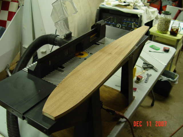

    Never did find out how big this square hole was...
    It would make a difference about how it was approached ...
    This was drilled at the corners so I could FIND the hole after the Mahogany skin was epoxied in place
    The router with a bearing pilot for a guide , made EASY work of cleaning the edges
    Later I cleaned the corners with a file.
