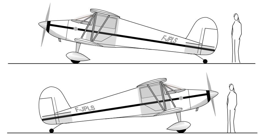

I discovered Westfall negative stagger biplane in Sport Aviation of october
and found that this cabin biplane was great, I couldn't resist to draw a
microlight-LSA variant with a VW 2180 70HP engine
I took same dimension gap 46" and chord 42".

High Definition (300dpi) PNG side view
https://drive.google.com/file/d/1_ps...ew?usp=sharing
P.S : I use english and french, but in the latter case I think that drawing would help even if you don't know french.
