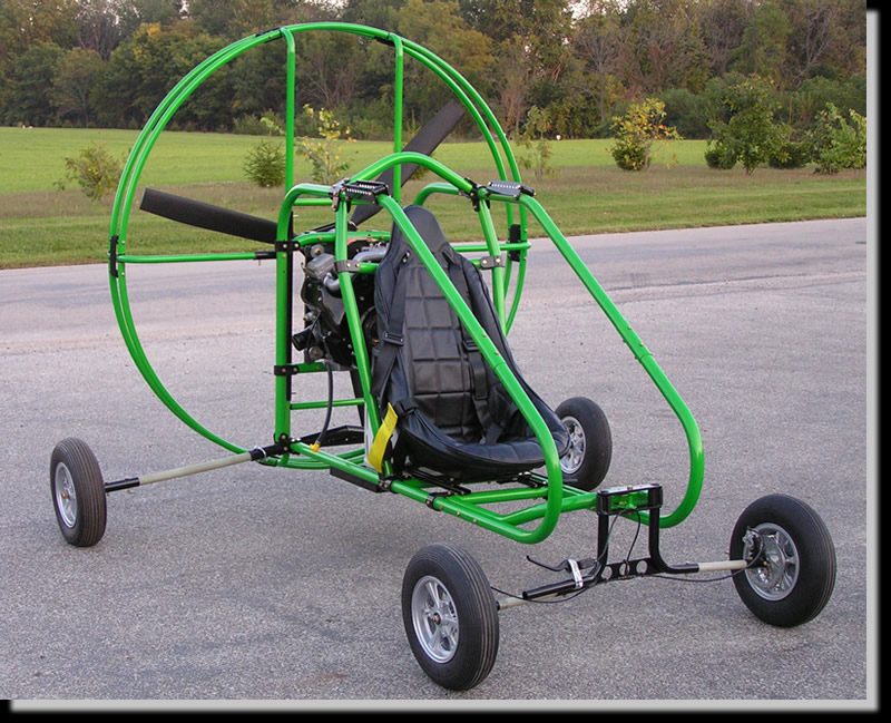

    Thanks for replies folks. Bill, I'm talking about the aluminum brackets that are used to hold together the frame parts, not the velcro for the prop guard. You can see them as black (mostly) u-shaped bands in these pictures holding the green tubes together: https://www.picclickimg.com/10/!B0h1..._id=880000500F
    https://www.planetppg.com/pagepics/G...ICT0089web.jpg
    They are obviously flat aluminum bent in a U-shape; question is how are they bent, with what techniques and tools?

    Just make a small press form with 12" scrap two by fours about 1" apart (screwed down to plywood) on the floor.
    With a 24"X 1" pipe just step on the pipe and press the strap into the slot. Might need a 7/8" pipe or other size for spring back, just experiment.

    Look up the bend radius allowed for the particular alloy. Aircraft Spruce has this info in the catalog.
    It will give the bend radius allowed for the thickness. For example, it might require a radius two times the sheet thickness for alloy 2024-t3. Check for cracks on the edge after bending with a 10X magnifying glass.
