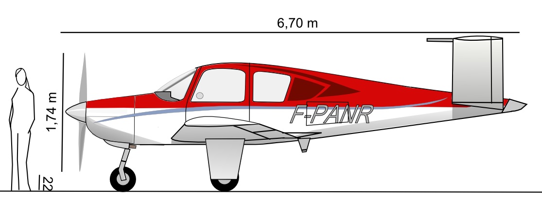

    Proposal for a light 2+2 seater. Useful load 840lbf. V-tail is inspired by the Davis DA-2
    Some specs
    https://docs.google.com/spreadsheets...it?usp=sharing
    You can download the .png for better view (Google Drive zoom doesn't always cope with online viewing)
    https://drive.google.com/file/d/1pIK...ew?usp=sharing
    Takeoff ground run with quadratic interpolation (Snorri Gudmundsson)
