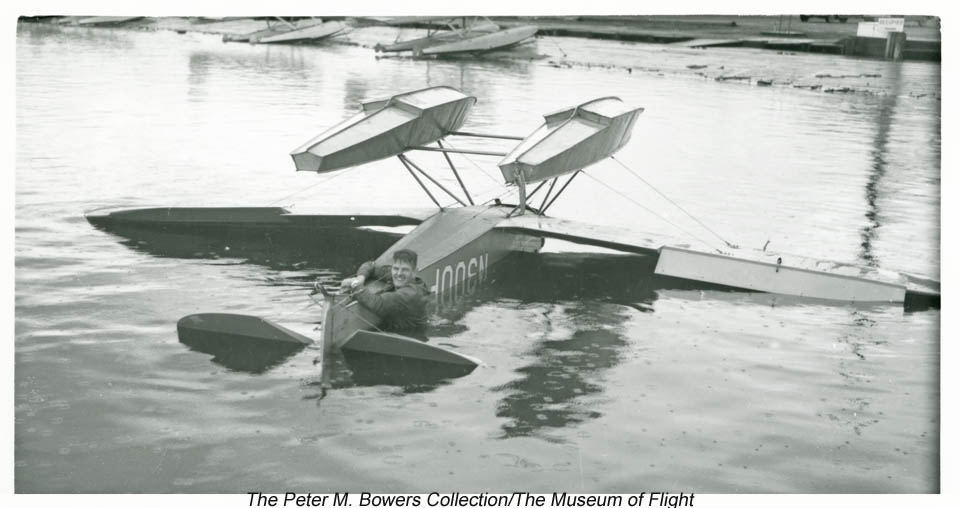

    The Fly Baby community says, "Go for it!"

    The other aspect is the positioning of the center of flotation for the pair of floats. That's what happened in the above photo; the floats in use were properly sized, but were installed a bit too far aft.
