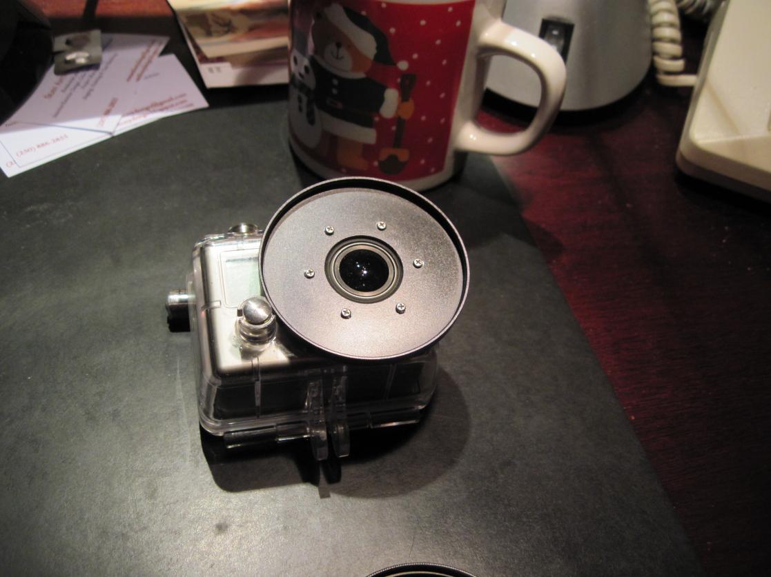

    GoPro case modification for large 58 mm ND filter
Size:  89.3 KBName:  IMG_0562.jpg
    A couple of pictures here showing the modification to the GoPro Hero video camera housing to accept ND filters. I used the same mounting holes as are used for the lense cover and drilled out a 'step-up' filter adapter to fit. Works great.
