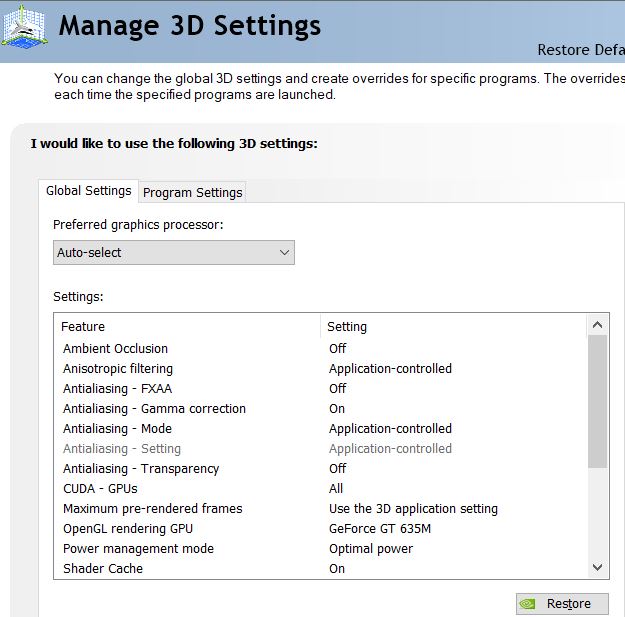

    So I dug into my graphics card driver, and it does have OpenGL - it was previously turned off, and Solidworks was not one of the programs that the computer recognized as using OpenGL.
    So I turned it on, and associated Solidworks with OpenGL in that menu -- and it still isn't working.
    Name:  3d options.JPG
Size:  76.3 KBName:  2d options #2.JPG
