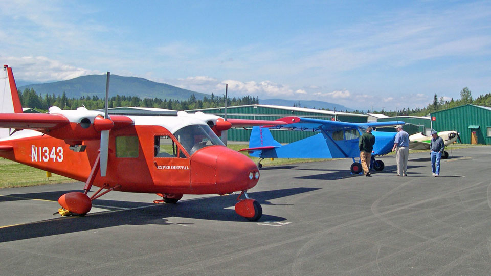

    Case in point. Take a look at these three homebuilts:
    The blue single-engine one in the middle is the Wickham "A" ("Bluebird") that first flew in 1955, and the twin in the foreground is the Wickam "B", which flew about 1967. Both are all-metal, 2024, I believe. Though they might have been 7075. The third airplane is some obscure wooden type. :-)
    Anyway, the designer/builder of the first two was Jim Wickham, a configurator for Boeing Commercial Airplanes. It was his opinion that airplanes built from aluminum did not need additional corrosion protection, and neither of his airplanes were primed.
    The Bluebird (single-engine) was restored in the ~90s. Didn't hear of much anti-corrosion work needed. However, the Bluebird was an active airplane through most of its life, and was mostly hangared, I believe. The A&P who does my Condition Inspections did the restoration (and he parks the plane across the hangar row from my Fly Baby).
    The Model B (twin) was donated to a museum in ~1980, who parked it outside for 10-15 years until a chapter member bought it. He found massive corrosion in the wings.
    So....it's basically a crapshoot. If I were building something from 2024, *I* would prime the thing. And as Falcon21 says, if you apply Corrosion X during construction, don't expect to be able to paint the outside of the airplane. That stuff will weep through various holes (as it's designed to) and ruin any chance for paint adhesion on the outside.
