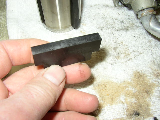

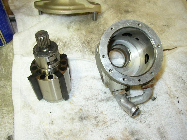

    When a vac pump is operating, the angle that the carbon vanes are set into the rotor and centrifugal forces causes the vanes to make a better contact with the walls of the pump. when a vac pump is rotated backwards at the speeds we turn the prop, there is no centrifugal force, so friction on the walls of the pump cause the vanes to be pushed back into the slot they ride in, and away from the pump walls.
    If a pump fails when turned backwards, the vanes were so short they cocked in the slot they ride in. IOWs it was worn out to start with.

    Tom, those lovely photos look like a Sigma-Tek metal-hub vacuum pump which uses non-canted vanes and is bidirectional. Most pumps (Airborne, Rapco, Tempest) use a graphite hub with canted vanes and are designed to turn in only one direction (e.g., 211CCW or 212CW). I've actually never seen a Sigma-Tek pump disassembled before, that metal hub and big ball bearing are impressive. No wonder they cost more. --Mike
