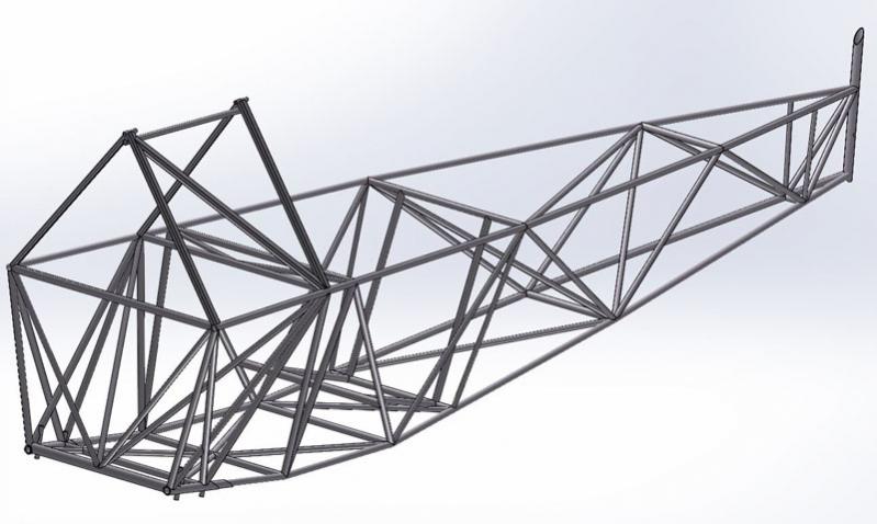

    Here is a pic of where I am so far.

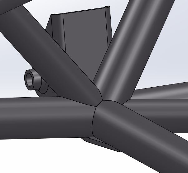

    On my Pitts model I did all the tubing structure as a weldment and inserted that part file into an assembly to add the fittings. No automatic trimming for those parts and I made no attempt to create perfect fits between added parts and the tubing structure -- those mostly get done by hand anyway. I highlighted some of the faces below to show what I didn't trim;

    This is the weldment by itself, structure only -- even the tubular fairleads aren't modeled here.

    Thanks so much for your great reply. You pretty much confirmed what I thought. Draw as much as I can using the weldment module and anything that deviates from that even if welded on is added in an upper level assembly CAD file. The only downside to this is some of these items would also affect the nearby tubes and I wanted to have these cut at VR3 Engineering as a tube kit. So with that said, I will have a tubing kit about 90% coped with a few items that will need hand adjusting to work with the items I added in the assembly. I might still be able to use cutting planes and such but that may not be worth the added effort.

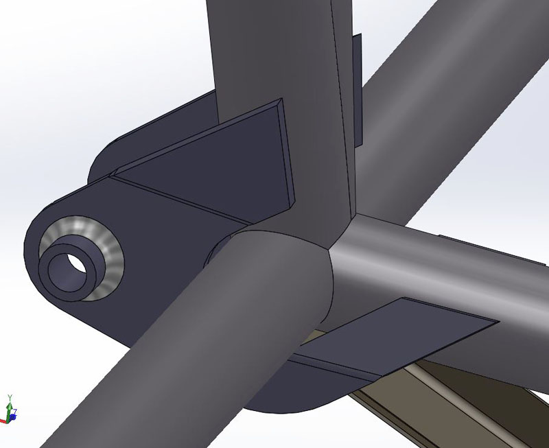

    You can use the JOIN feature to add parts to the structure after first creating them separately but getting a realistic result may be difficult. My lower rear wing fitting would have a weld bead added where there was contact or even close proximity between parts and there are places where the sheet metal fitting would be heated and tapped around the tubes prior to welding. Modeling all that could be very time consuming. I have not done FEA on weldments but I can imagine the amount of time it would take to get a solution.

    Yes I have a bunch of items that mention heat up and bend to touch the smaller tube on the other side and for that it would not be fun to model and trim on a tube at an off angle. I think I am going to take your advice and do as much as I can as a weldment and where I cant I just add the parts in the upper level assembly.
