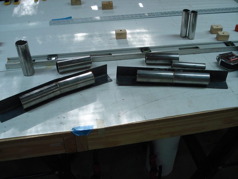

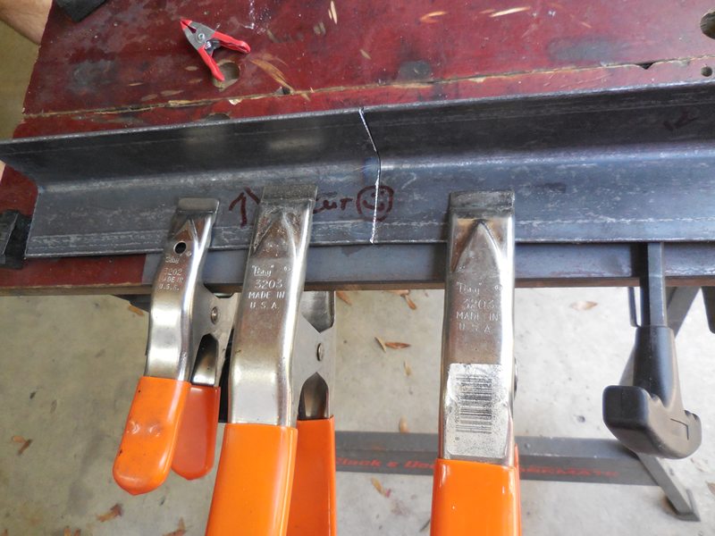

    Another modification to the basic kit is to use round stainless steel tubing for the wing connectors rather than the flat steel plates provided. Since the wings have sweep, and the lower wings have sweep and dihedral, the connectors must be cut at the proper angles and welded.
    The upper wing is easy, just a 3 1/2 degree angle cut on each side. The lower wings are a little more difficult as each side has a 3 1/2 degree sweep and a 2 1/2 degree dihedral. I could have set this in my chop saw, but my wife being a college math professor and son a computer hardware and software engineer, they took on the vector analysis to come up with one combined angle cut. After quite a while, they came up with a combined angle of a little over 4 degrees. This now has to be divided in half since the lower wings plug into a straight carry through.
    Here are photos of the cut parts and welding jigs I made up:
    My son Rob helping cut the tubing. Lots of sparks
    Lower wing jig. Smiley face is to help me remember which ends mate up.
    Parts in jigs - they should work!
    Since my welding sucks, and I don't even want to consider welding stainless steel, I took the parts to the local college for their welding school to help out. They have a really top notch school and instructor.
    Here is the result

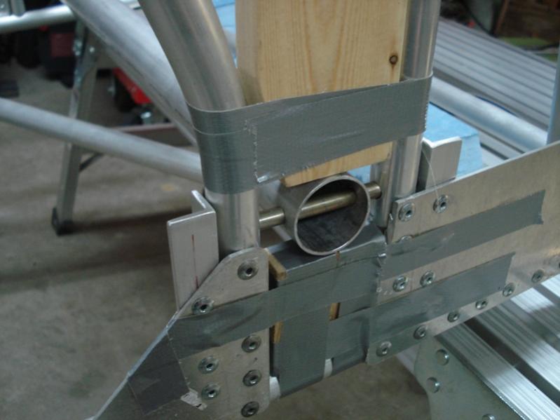

    And finally the test fit - YES! (ignore the finger in the photos)
    I have since angled the root ends of the spar tubes to fit up to the welds closer. I am now working on jigging up the carry through tubes so they will not move up and down while I remove the bolts to insert the connectors. Once it is all lined up, I will put a rivet in the carry through and connectors, then remove the assembly to match drill the connectors for the attachment bolts.

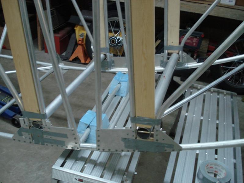

    Jigging the carry through tubes so that I can insert the connector with the bolt removed from the carry through. They need to move front and back for alignment, but can't move up and down while fitting the wing spars. I will leave one side bolted while working on the other to keep the carry throughs from moving back and forth.
    I will jig up the fuselage then the wing outer ends for mating up with the fuselage. The lower will be a hoot getting the connectors in the right position, but my wife and I did it once as a test, so it can be done.

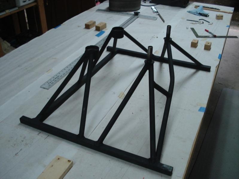

    Engine mount
