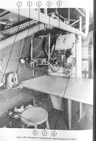

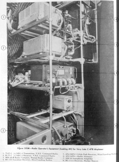

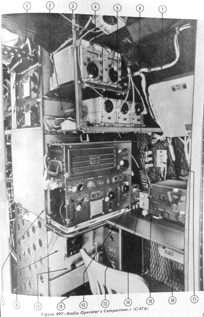

    The bottom picture of The Other Ron's posting looks like a BC-191. Back when I was a CAP cadet, me and another cadet found a stack of these in the squadron "junk room." Didn't have the dynamotors, though.
    This is the type of picture I'm looking for. The equipment in the top of the rack is the SCR-274N Command Set consisting of 3 receivers, 2 transmitters, the antenna relay, and somewhere is the modulator. What is unseen is the transmitter and receiver control boxes in the cockpit. I have located this picture on the internet but I don't know what tech manual it is out of.
    The large set beneath it is probably a BC-191, or possibly a BC-375, and along with the set on the table, which is probably a BC-312 or BC-348, and the tall box under the table, the antenna tuner, made up the SCR-287 Liaison radio system for long distance communication.
